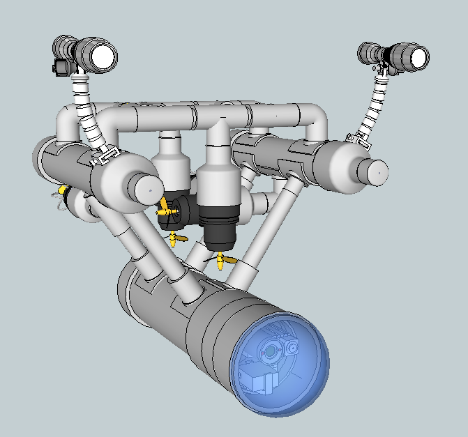

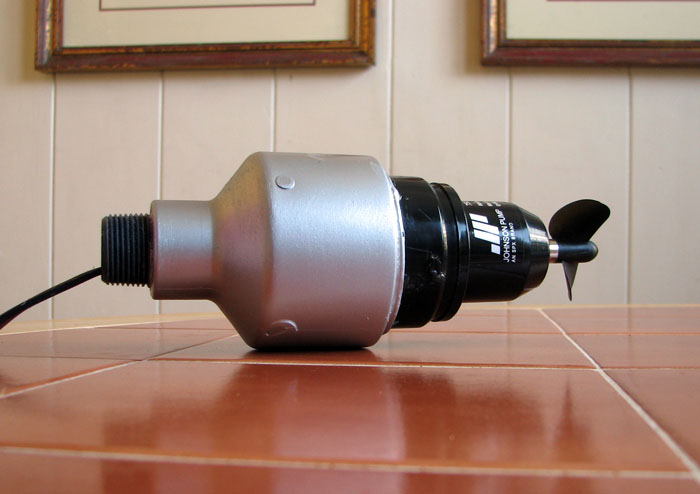

Near the bottom of page 4 martinw was wondering what bad effect the vertical props being so close to the main hull might have. derelicte suggested trying to shorten up the bushing assembly to create more space. That idea didn't work out so well. But after a long search I found a Canadian company, http://www.spears.com, that makes a 2" x 3/4" reducing coupling (part no. 429-248), which will make a much nicer transition from the motors to the frame. I was hoping it would also shorten up the motor assembly. It did, but only by about a 1/4".
This same part makes a nice "nose cone" for the upper buoyancy tubes, which are also now 2" diameter. The attached pics show the new motor assembly and the "nose cone" use of these couplings.
- new thruster 005_adj.jpg (69.5 KiB) Viewed 10168 times
- ROV23_rev3_front.png (107.05 KiB) Viewed 10168 times

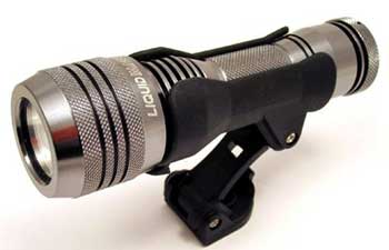

I see there is now another similar option available. It is a little less bright, the beam angle is somewhat more narrow, it offers less separation distance between the lights and camera, and it doesn't offer adjusting side-to-side aiming. But it has the advantages of being more compact and less expensive. It is probably perfectly suitable.
http://www.amazon.com/Liquid-Image-4-7W ... d_sbs_sg_5
- liquid-torch.JPG (9.02 KiB) Viewed 9878 times
