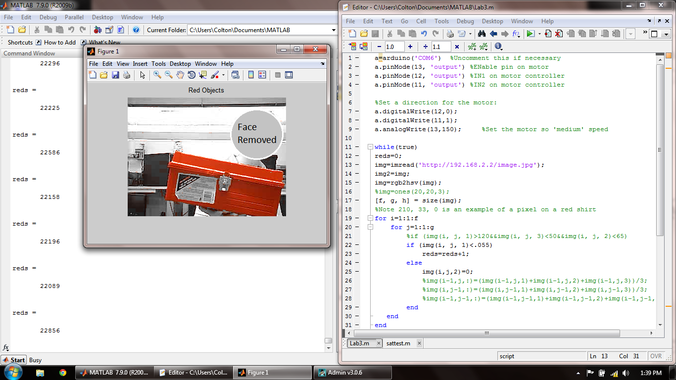

This past week we made a good bit of progress on the controls. We showed the ability to transmit images over a wireless network using a network camera, and the ability to process these images and send commands to a microcontroller based on the images. The setup looks something like this:
To show that it works, we made a program that stops the motor when the camera sees a red object. Our autonomous search function will be based on this framework.
Here's a screenshot showing the color detection.

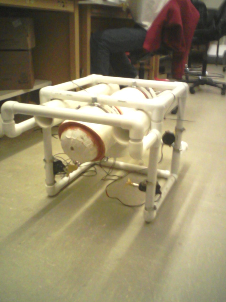

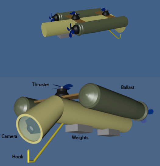

And... I'm back! In the past couple weeks we've gutted our boat and started turning it into a AUV. We've got a hull made of 6" PVC pipe with a camera dome in the front. (Shown below)
hull
hull

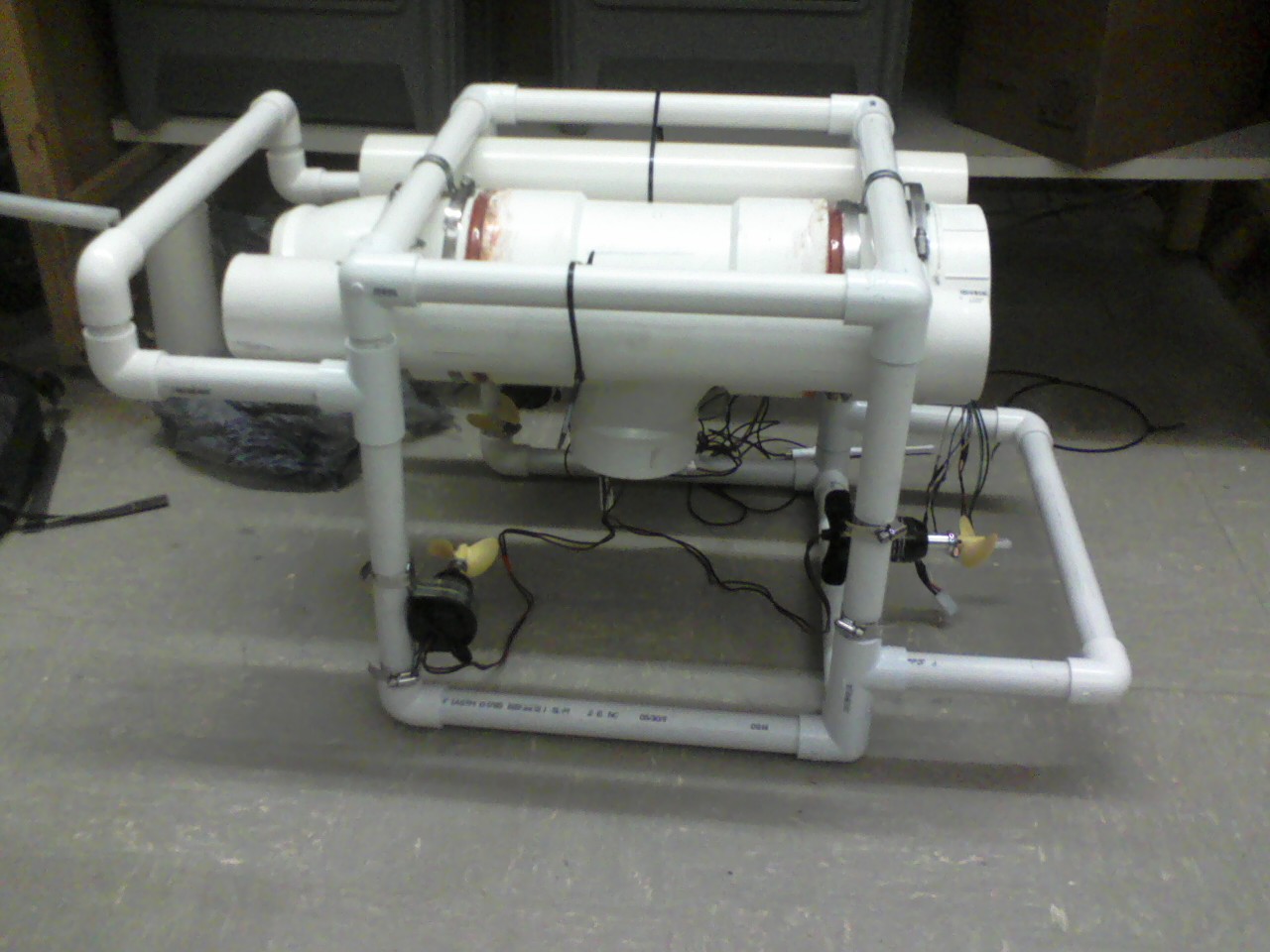

It needs to be cleaned a little, but you get the concept. We've also got a mockup of the frame that will allow us to mount thrusters, ballasts and weights.
frame
frame
We came up with a pretty neat system of hose clamps and pipe straps that allow us to easily move the motors around so we can find the optimal position for them. I highly recommend it.

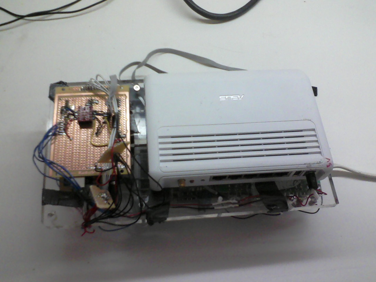

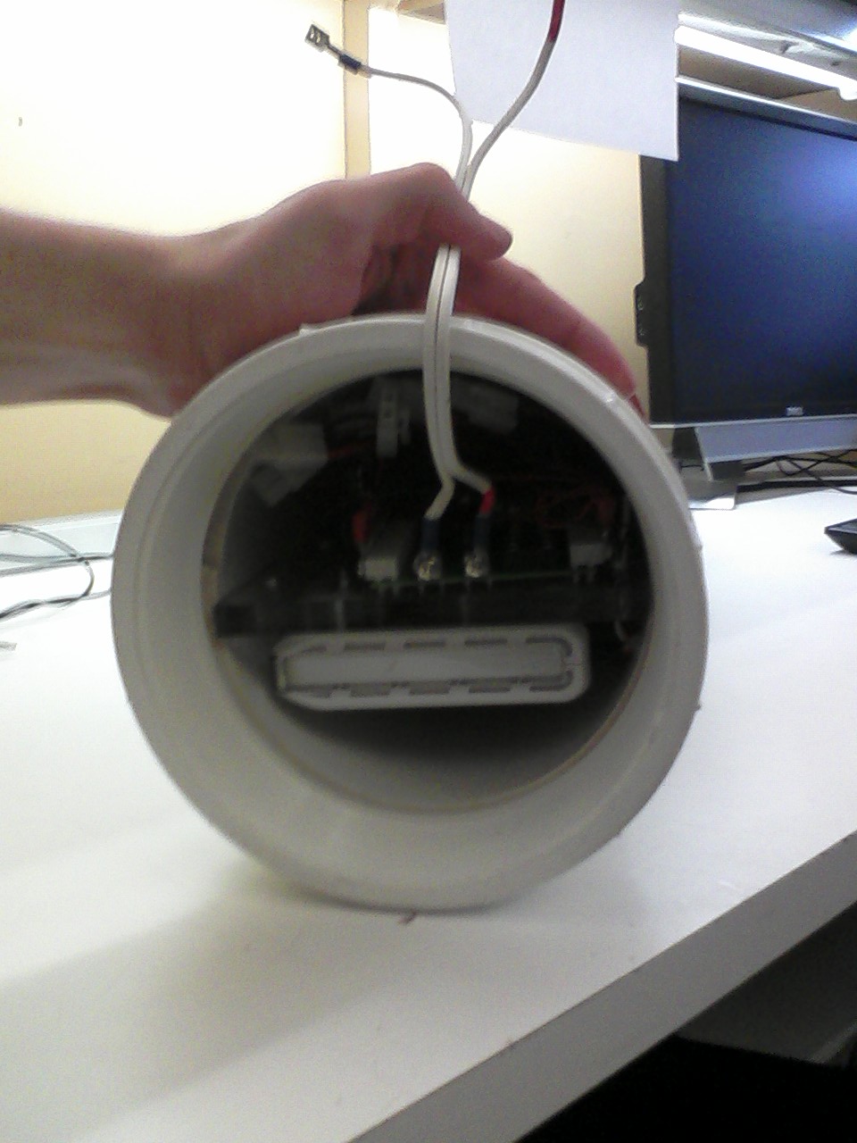

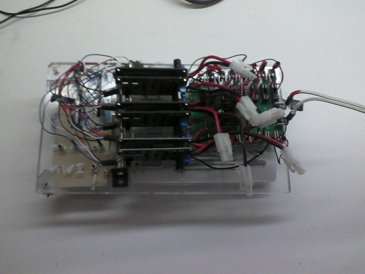

Finally, we have all our electronics wired up and mounted. Note: our camera isn't shown, we're still mounting it. The IMU is also not attached to the board yet, because its expensive and we don't want to damage it.
We decided to try having the wireless router inside the robot, with a long antenna wire trailing to the surface. We haven't tested this part yet, so we have no idea if it will work.
We're getting pretty close to having a robot in the water. We need to do some more testing of the pressure vessel, because it would be rather expensive if it failed with the electronics onboard. We're also in the process of finding a distance sensor that works well underwater. After failing to waterproof a hobby ultrasonic sensor, we've ordered one of these http://www.ebay.com/itm/Waterproof-Ultr ... 0721354139. Hopefully it can be made waterproof, so that our robot can find its way around the pool on its own.
One last teaser about how the final robot will look:
Cheers,

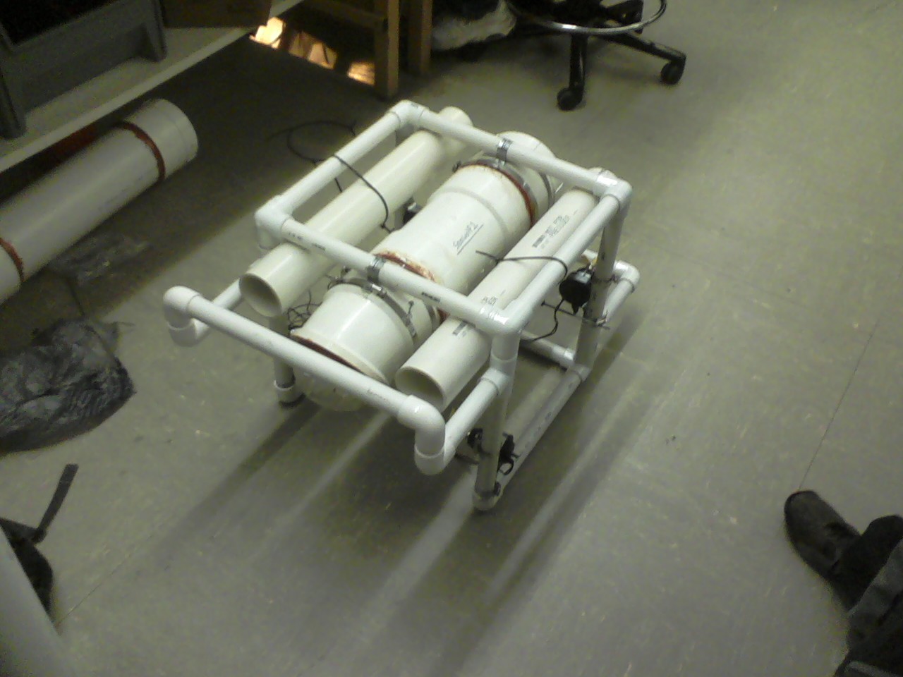

Well, its been a while. Here's a quick update and some picture.
We've tested the first ROV int he water. We're having some trouble with our sensors, but we hope to have that figured out by the end of the week.
The first ROV:
ROV1
ROV1
2
2
The pipes at the top were the mockups of our ballast tanks. Unfortunately, due to time constraints we won't be able to get working ballasts on our robots.

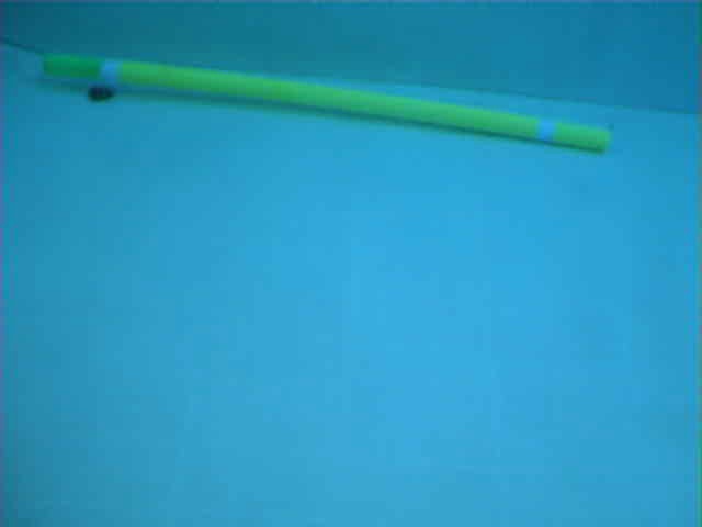

Our goal is to have two robots autonomously locate and move a long pipe in a swimming pool. Unfortuantely, we're rapidly running out of time, so the 'moving the pipe' portion of the task will have to be shown in simulation. However, we think we can get collaborative search figured out by the end of the month. Here's an image we took of the target pipe underwater. The picture was taken using the cheapest network camera we could find.

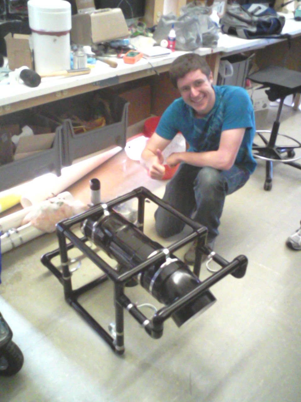

The second robot after paint:
