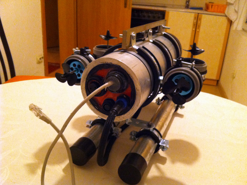

Getting the final quirks sorted out and could use some advice.
In short, main body getting ready, I’m happy how it turned out and would like to stick to this path. Resemblance to Steve’s Stinger and the more commercial Observer type. Many, many, many mistakes along the way, some of which I would be happy to share and some that I will keep for myself :oops: . Right now I am figuring out a better buoyancy setup since body is too heavy. My ROV will be used mostly in salt-water but from time to time in a lake as well, so I am thinking to use some kind of tank on top that can be water filled as needed. I will check the posts again to see if I find any text on that. Overall balance is fine however, just a bit back-heavy thanks to the connectors, think I can compensate that fairly easy.
Will post pictures of the control system as soon as I manage to squeeze all on a board. I had to change a lot because of some power issues (some of which I got help on here). Was thinking of cutting the tether to 60 m but decided to stick to the original plan of 150m. Control seems to work fine (on reel and on land) I am sending 24v topside to a 12V 20A converter for power. The brushless motors I have tested as deep as 20m (lake) without issues and I changed to a small HD camera that’s ballooned topside instead of the Axis 221 beast (could not fit it in). Tether management I will worry about later, right now depth and seals are priority followed by motors.
Will post updates regularly I hope.

A final test before the lake. Did not include lights yet (still working on them).
Changes include new skids, tether cut down to 80m, floats added (temporary and ugly), video feed, control box.
