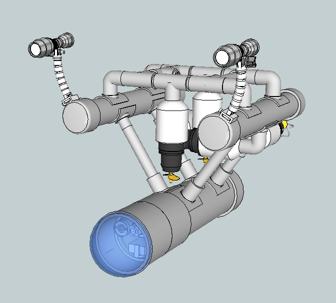

I finally got around to doing buoyancy calcs on the revised design. I was shocked to realize it was more than 10 lbs positive buoyant! I have changed the 3" dia. upper hulls to 2" ones. It's now about 6 lbs net positive buoyant, which seems like an acceptable amount of ballast to add.

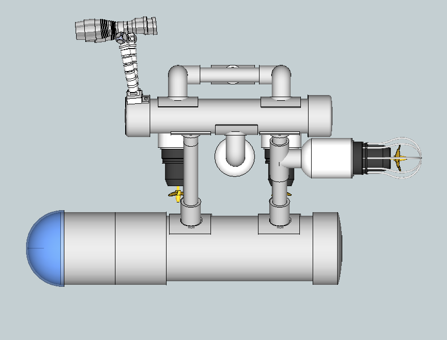

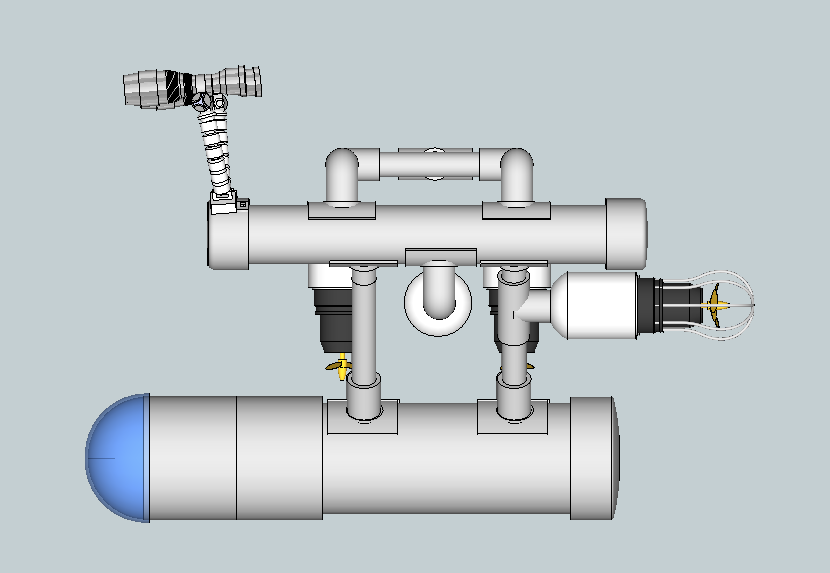

derelicte, good eye! You are exactly right. I was able to reduce their lengths by 3.5" each. This reduces total volume by 31 cu. in. and reduces total vehicle weight by 0.4 lbs. The net benefit is ballast is reduced to 5.33 lbs, a roughly 12oz reduction. Thanks!
Here are before and after port side views:
- ROV23rev2port.png (53.31 KiB) Viewed 10680 times
- ROV23rev3port.png (61.05 KiB) Viewed 10680 times

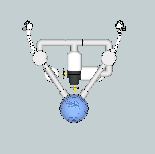

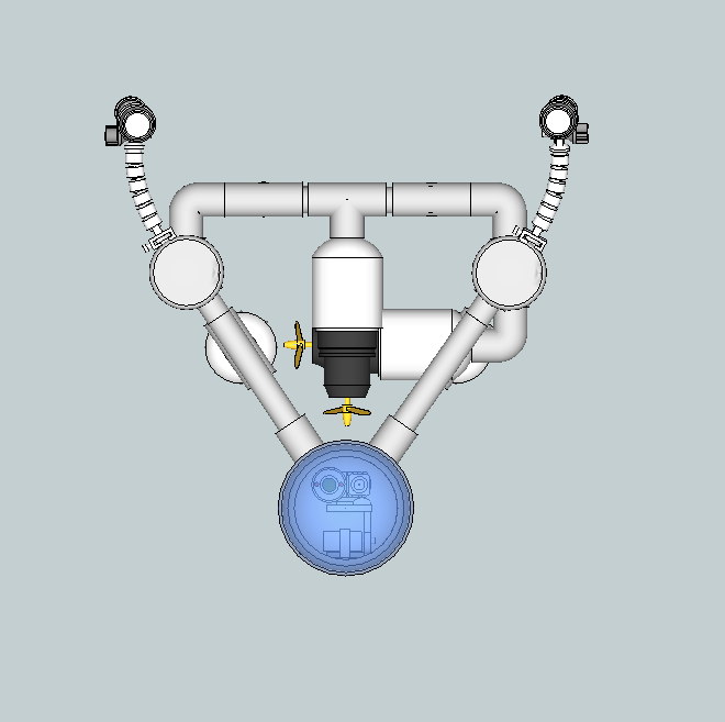

I might be wrong but the flow of water from your vertical thrusters looks like it may well be limited by the camera housing beneath them?
Re: No Name ROV
martinw, hmmm . . . it's a good question. I'm really not sure. There's ample space for the water to escape, but the water being deflected by the curving hull might rob some thrust. Maybe making a test setup wouldn't be too difficult. Or I could just lengthen the nipples at the top saddle tees to raise the whole assembly an inch or so.
Thanks for bringing it to my attention. Anybody else have an opinion?
Here's a view looking from the front down the length of the hulls, which helps to visualize what's going on.

- ROV23rev3bow.png (54.12 KiB) Viewed 10661 times

you could also shorten the fat end of the reducer that the motor fits into.
In the end it may not matter, though. the motor itself is pretty fat and it doesn't seem to really effect water flow to or from the thruster.

I gave your suggestion a try. It proved difficult to do. I cut down the length of pipe glued to the motor housing, the length of the bushing, and the length of the coupling that fits over both of them. What I was left with proved really difficult to assemble. Those slip connections are slightly conical, and trying to insert them when they've been shortened isn't as easy as it sounds. I made a mess of it.
BUT I finally found a source for 2" x 3/4" reducer couplings (not bushings) - the kind with a conical section between the 2 sizes - which is really what I wanted in the first place. It'll provide the hydrodynamics I was trying to get with the little domes I've been showing. I haven't received them yet, and am not certain what their overall length is. I should know in a week or so.
