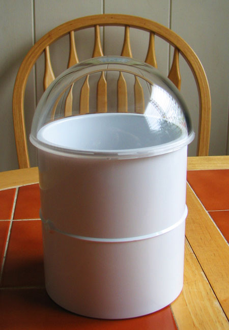

derelicte, the optical acrylic dome arrived today. It was very well packaged with paper wrap, plastic bag, and 2 large sheets of bubblewrap, which was a good thing because the box was smashed all to hell.
It's true what was promised, the dome is very sturdy and optically very "clean," without distortions or waviness.
There was a very slight lip on the inside of the base, which prevented it from fitting over the end of the 4" coupling. I spent about a half hour sanding it off and easing the edges of the dome and the coupling. It still wouldn't quite fit over the coupling. I heated the dome in hot (not boiling) water, and it fit over the coupling! It still needs more sanding to get it to fit further down the sides of the coupling. I'd like to see a minimum of 1/4" overlap. Right now it is only about 1/8".
Anyway, compared to some other domes I bought, this thing is far better.

How deep would you say this dome might be good for?
Re: No Name ROV
thegadgetguy asks, "How deep would you say this dome might be good for?"
The short answer is I don't have the foggiest idea. Acrylic, like all polymers, can be made to have a wide range of physical properties. I have no idea the specs on this acrylic, and it probably wouldn't mean much to me if I knew. This acrylic is 75% the thickness of the 4" PVC. The domed shape is a natural for resisting external pressures. I'd be very surprised if this dome fails at less than 100 meters.
My guess is I'll discover some other factor, like the com wires of the tether, that will put a depth limit on the rig.

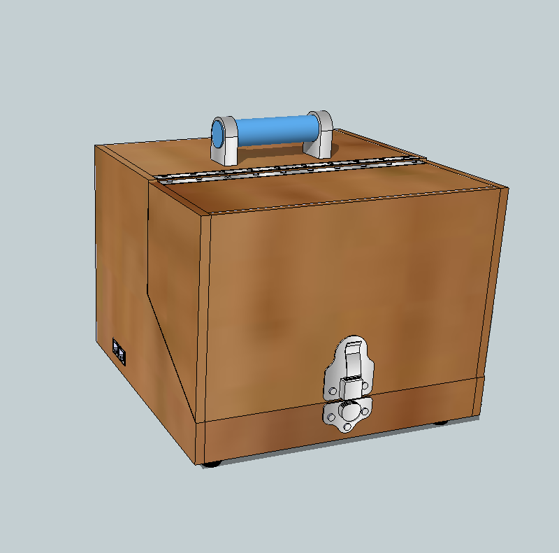

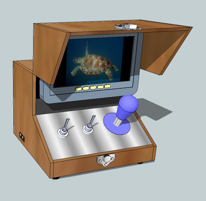

I've been working on a design for a little ~ 8" cube wooden box that opens up to be the control console for the ROV. The monitor is a 7" screen intended for video and rear-view display in vehicles. There's an 8-pole joystick for controlling the ROVs propulsion motors; and two 3-position toggle swiches, one for diving and surfacing, the other for operating the tilt of the cameras. In the rear portion of the box is a 12V motorcycle battery that powers the monitor and the control signals. The bottom of the monitor just clears the top of the battery as the lid closes.

The turtle is a nice touch!
