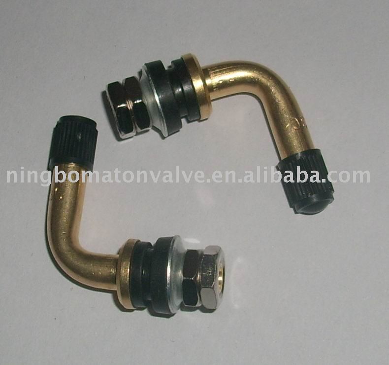

You can also pressurize your ABS enclosure with 5 to 15 psi, to give you a safety margin if you should go deeper? Another way to look at it is.... if you pressurized your box with 14 psi, it be greater then the water pressure, until you reached 10 meters. at that point the internal and external pressure is equal, just as if the project box was on the surface. As you continue to dive deeper, you will reach the 14 psi differential at 20 meters........ essentially extending your dive depth by 10 meters. MAny years ago we did this with two scuba tows we built. We installed a motor cycle valve stem, as they are threaded.
Jim
Jim
- PVR_30_motorcycle_tire_valve.jpg (50.3 KiB) Viewed 24195 times
