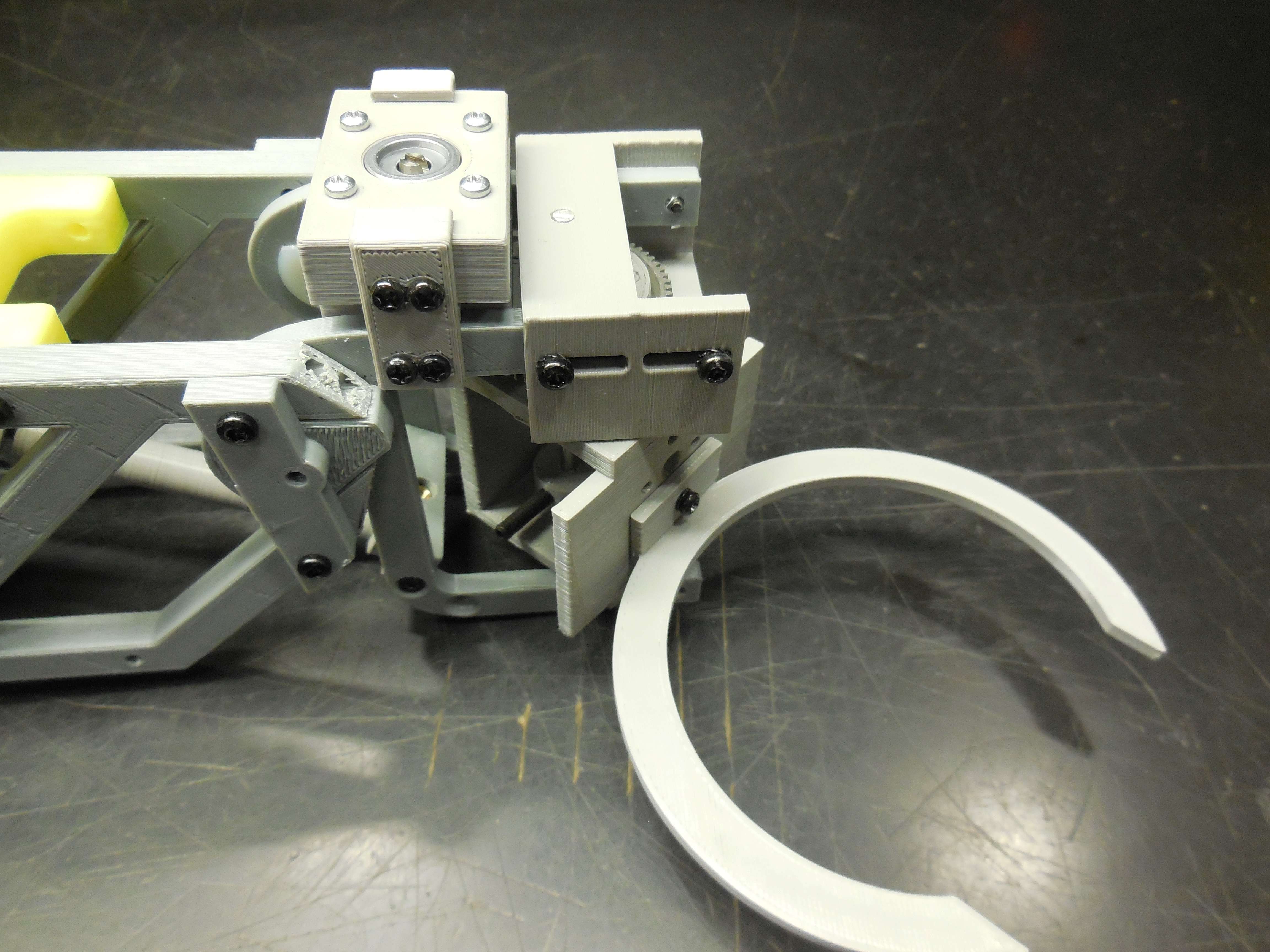

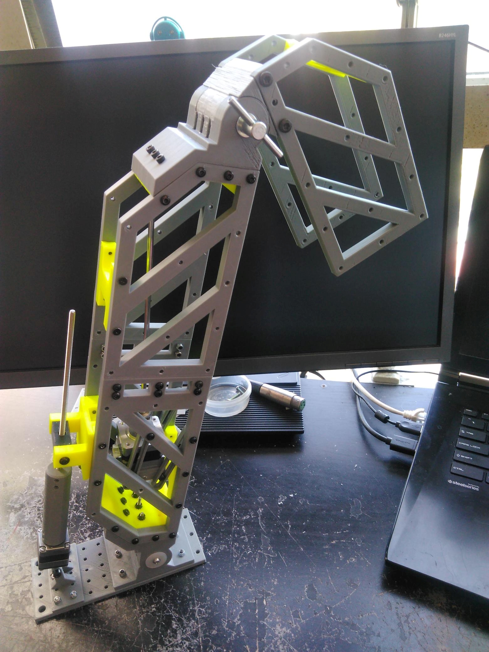

Update. I'm not going hydraulic. I'm going to use motors. I haven't decided between brushless or water proof steppers. I printed a few test parts to play with. I think this is going to take a while.
- DSCN9783v2.JPG (967.07 KiB) Viewed 147277 times
- 1000000185.jpg (794.79 KiB) Viewed 147277 times
