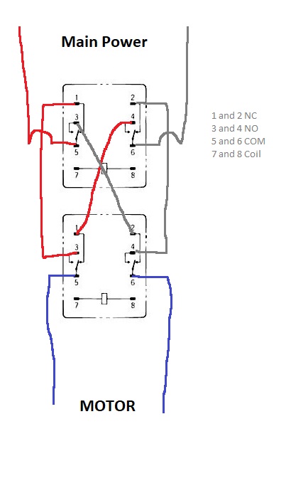

Re: help plz, no power to motors
This is how yours should be wired. (forgive the crude drawing)
(edit - Just to be clear you need two relays per motor to control forward and reverse.)
-Steve :rov:
-Steve :rov:
thx for the drawing, i helped a lot
