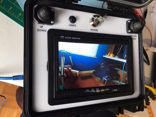

kennan345
Posts: 11
Joined: Mar 11th, 2021, 11:34 am
Re: First Project
Post by kennan345 »
Control box wired and ready to go
