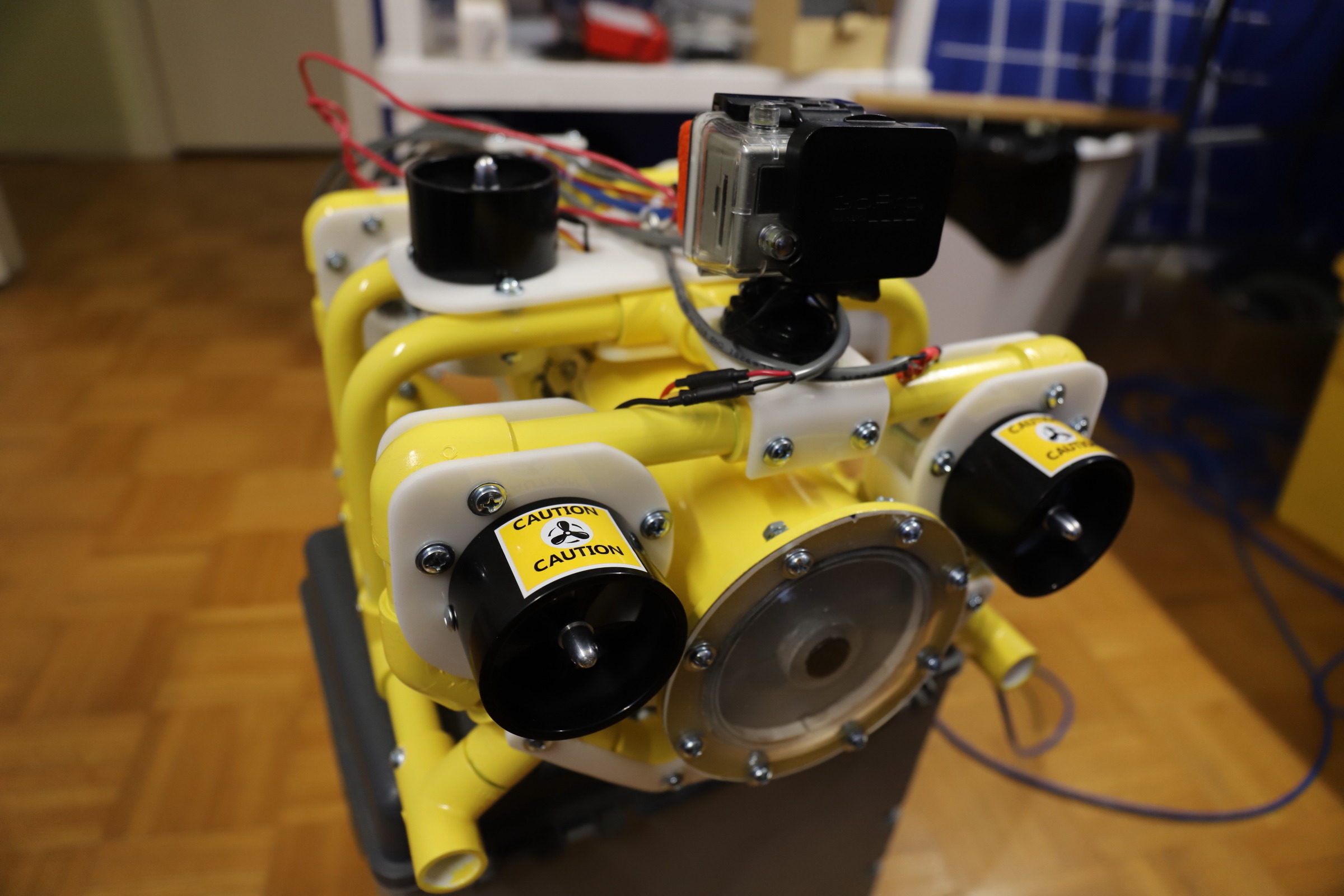

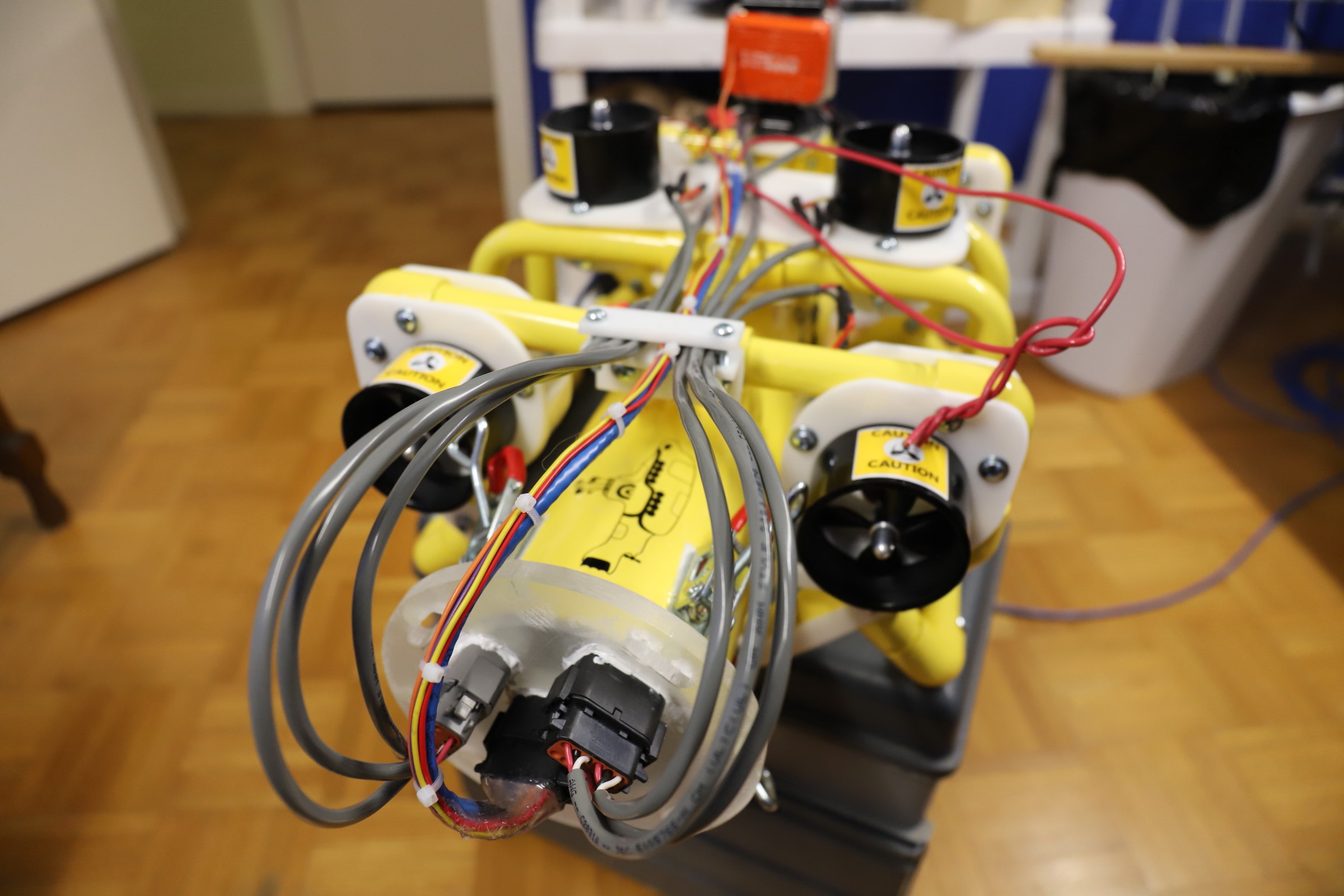

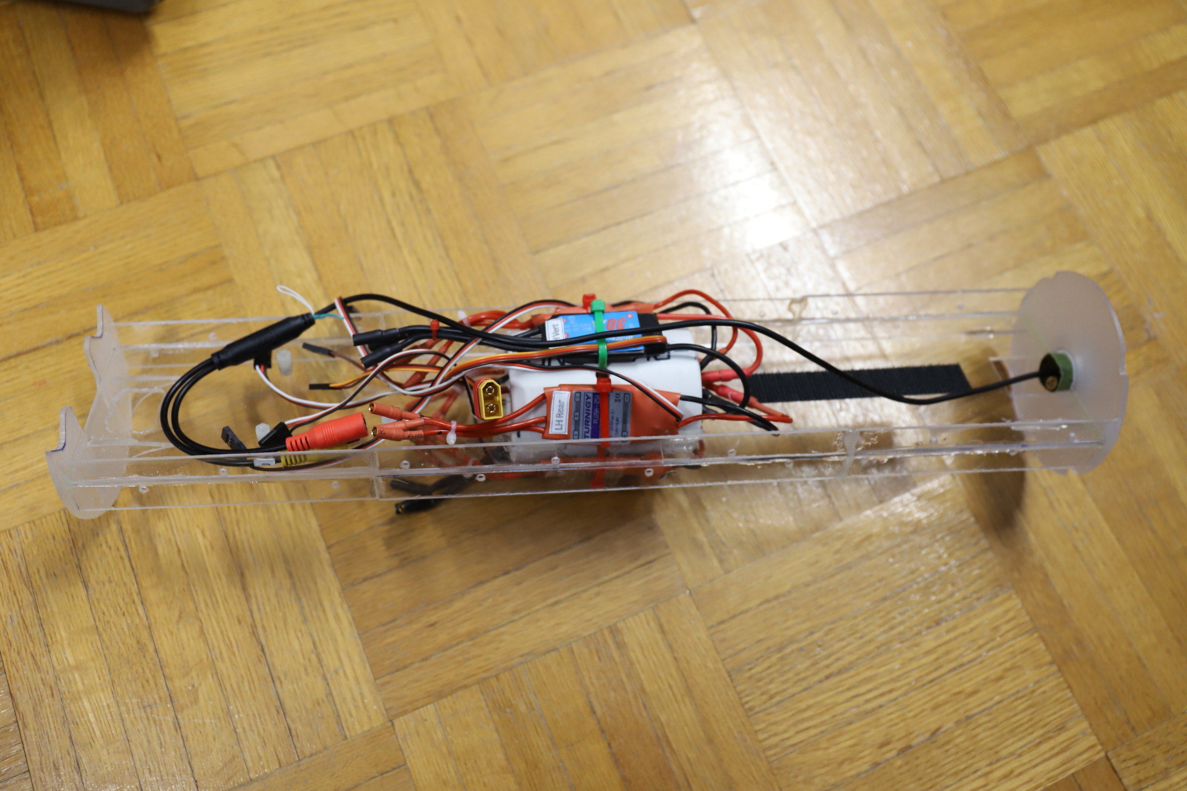

- Rear View.JPG (403.89 KiB) Viewed 56202 times
- Internal ESC.JPG (490.4 KiB) Viewed 56202 times
- Front view.JPG (484.98 KiB) Viewed 56202 times

Maybe you want to start your own build threat to post your photo's and code. Your ROV looks really nice.
