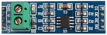

I use techmonkey based code modified for my own needs, easy transfer protocol, and RS485 boards that don't need control lines for the tx/rx switching. I had no end of problems with the cheap rs485 boards and went for slightly more expensive boards that detect when you TX and do the switching for you. I've not had any rs485 problems since changing to the better boards.
Re: Problems Arduino Nano V3 and MAX485 no clear connection
Wich RS485 Boards are you using now?bigbadbob wrote:Hi!

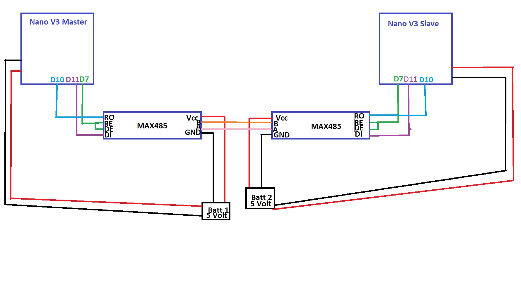

I have maybe stupid question. I using the MAX485 Bords and I power those boards and both arduinos with a seperate power source.
So the only connection between the two systems is the wires A and B.
Is it necessary to connect the GND together. GND from arduino Master to GND Arduino Slafe?
http://www.techmonkeybusiness.com/rov-c ... ition.html
Techmonkey connect Master an Slave over one GND wire. I think I have to do the same?
- Unbenannt.jpg (143.23 KiB) Viewed 41428 times

Buenas tardes.
La respuesta es SI, debes unir las masas o GND de todo el circuito.
Un saludo.
Good afternoon.
The answer is YES, you must join the masses or GND of the entire circuit.
Greetings.
asesorplaza1 wrote:Buenas tardes.
Un saludo.
Good afternoon.
Greetings.
Good afternoon
Ok, Thank you
No, this is incorrect. With RS485 you do not need to connect the grounds between the two modules, especially if the distance between the modules is short (<1km). Under certain circumstances you can end up with a high potential difference across both ends and then you need the ground, but normally just the twisted pair is all that is required.asesorplaza1 wrote:Buenas tardes.
Un saludo.
Good afternoon.
Greetings.
sorry for the late reply.
these are the ones that gave me endless problems-
and these are the good ones-
