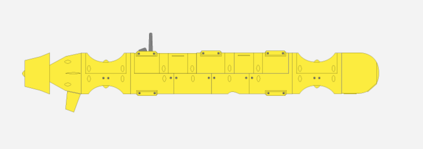

Hi Guys,
I am planning to make a Amethyst AUV Platform (https://beobachtung3d.com/) this summer.
This should be the final result:
Schermata 2020-06-17 alle 23.05.08.png (47.58 KiB) Viewed 159673 times

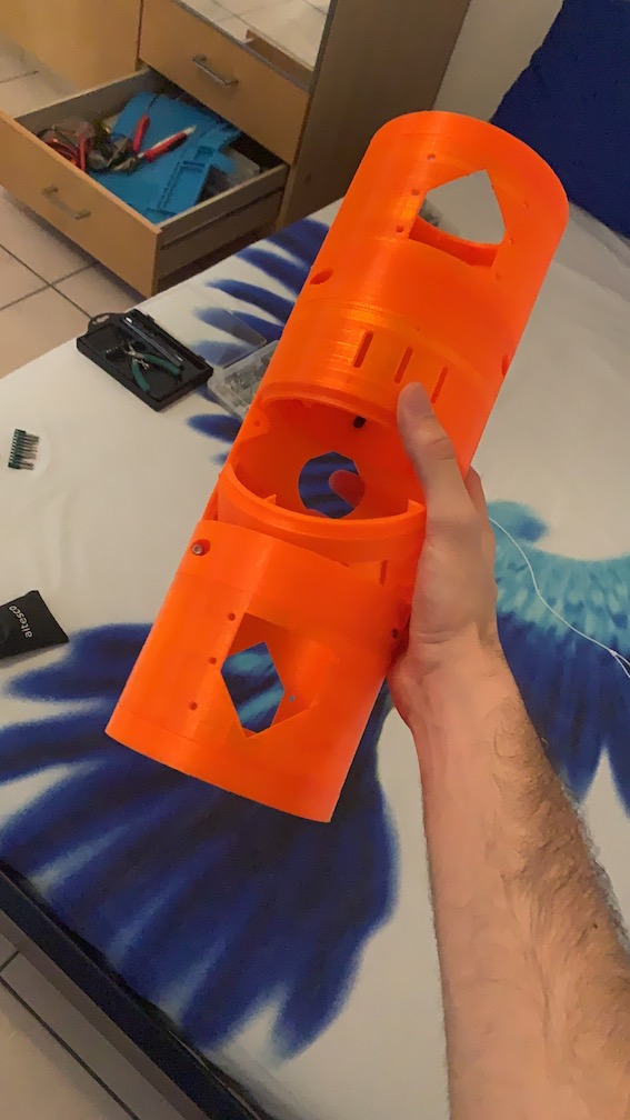

Here are the pieces I have printed so far...

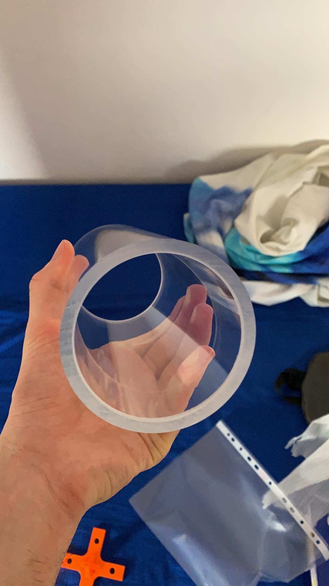

I already want to ask you something... Do you think a plexiglass pipe with the two caps 3D printed is a good idea (the DIY way) or is it better to buy an already made and tested enclosure? The enclosure I have found and that seems really good is by blue robotics (this one: https://bluerobotics.com/store/watertig ... e3-asm-r1/) what do you think? Have you had experience with their products? Do you know better companys maybe in europe (I live in Italy).
Thankyou for all the help and hope this project will be a fun one :) <><
Re: U-DRONE Amethyst AUV Platform
In the quick tests I did 3D printed caps (even printed at 100% infill) will not be waterproof at depth. I would go with a ready made enclosure like you linked especially if you have some money wrapped up in the electronics.

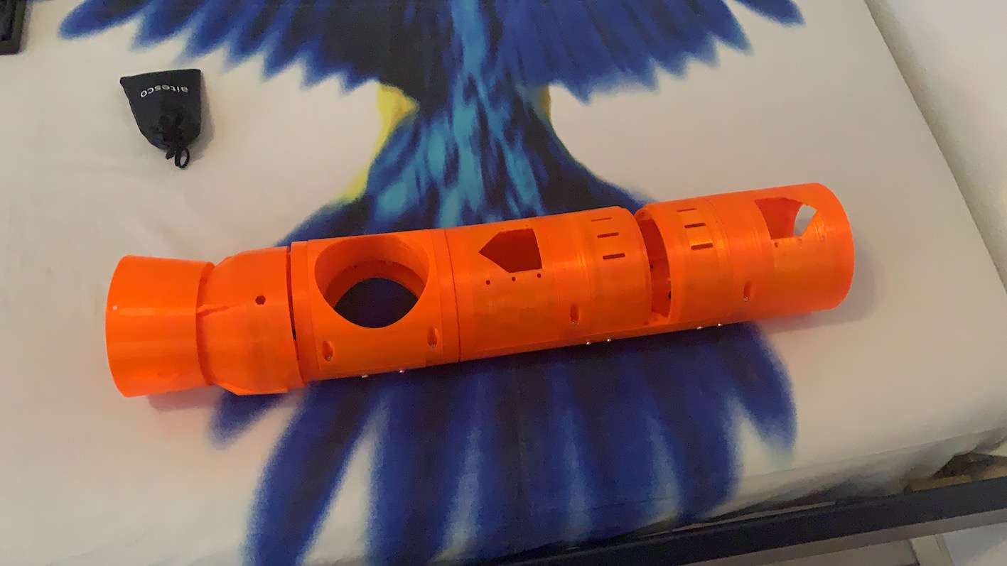

here is the progress.
So you all advise me to buy blue robotics 3'' series enclosure? I live in europe so the shipping will cost me...
This is the kit I am thing to buy. Maybe the cylinder a bit shorter. https://bluerobotics.com/store/watertig ... e3-asm-r1/

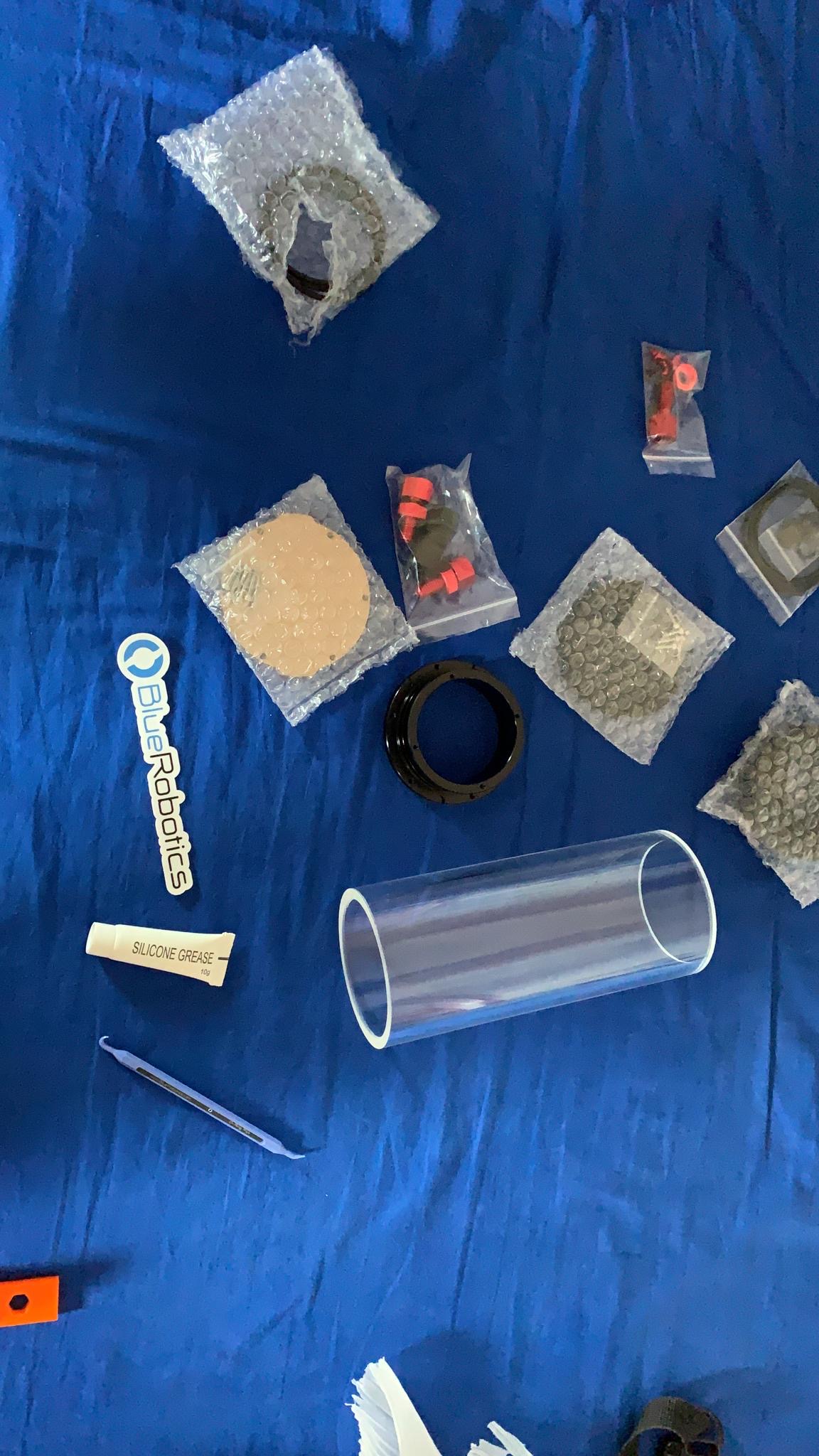

BlueRobotics team was amazing! Super fast shipping!
They also included silicon grease the little blue stick and a sticker!
This is the 3'' version.

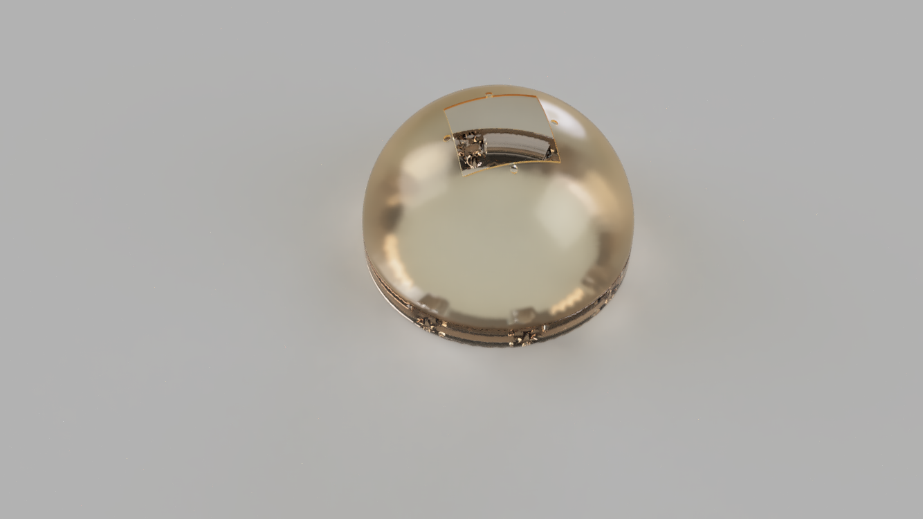

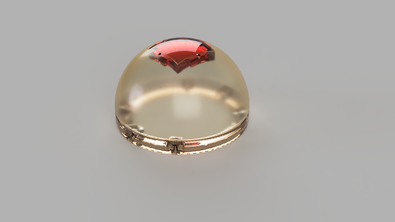

Heres a little update:
I made the 3D model of the front part. It has a detachable front so that I can insert a camera lens in it if i need or a probe such as a current flow probe.
Any thoughts?
UPDATE... Here are the 3dmodels (STL):
front dome.zip
(505.56 KiB) Downloaded 11597 times
Beautiful shape, only I think that the watertightness leaves something to desire. I think that you can achieve a better succes with swaping the whole dome if required. Because a flat surface is "easy" to make waterproof.
