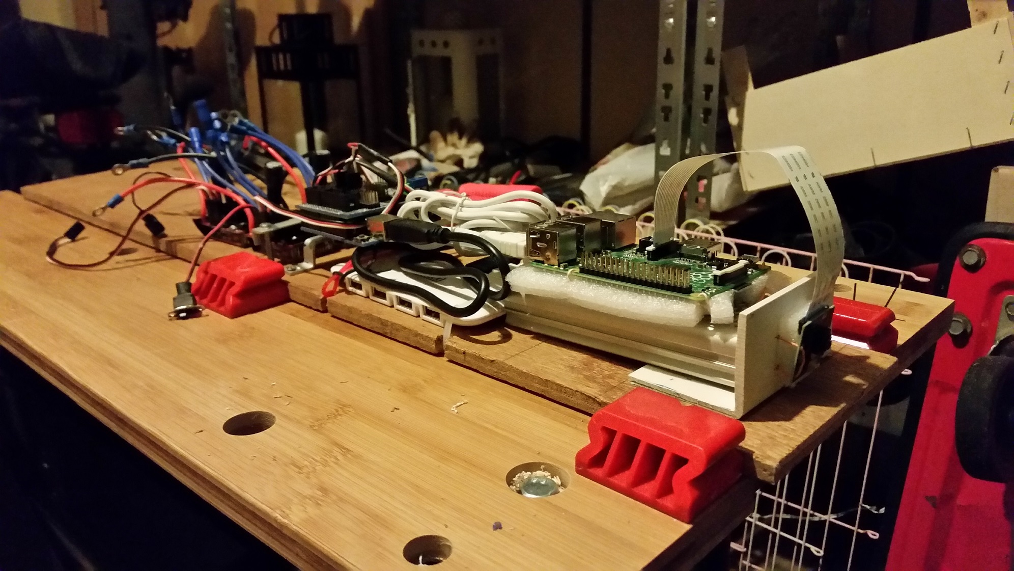

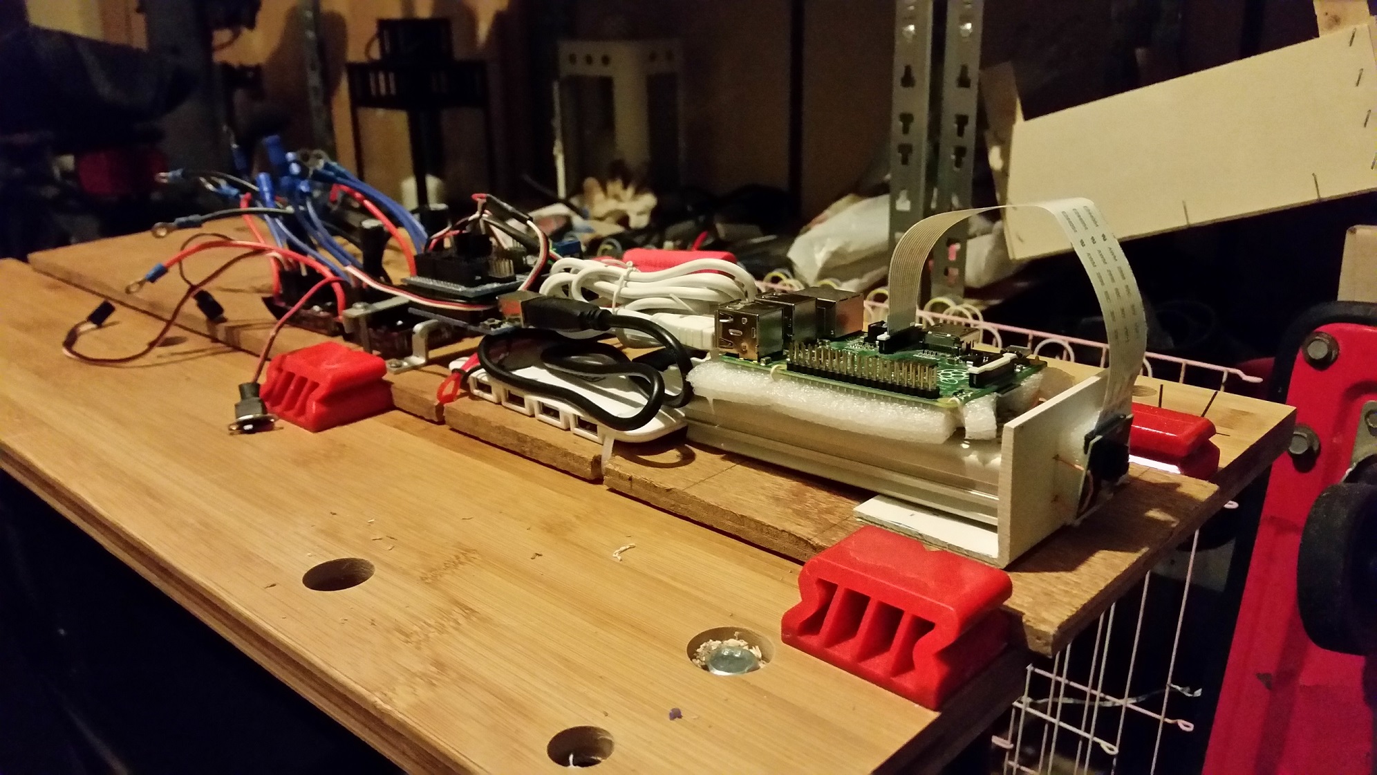

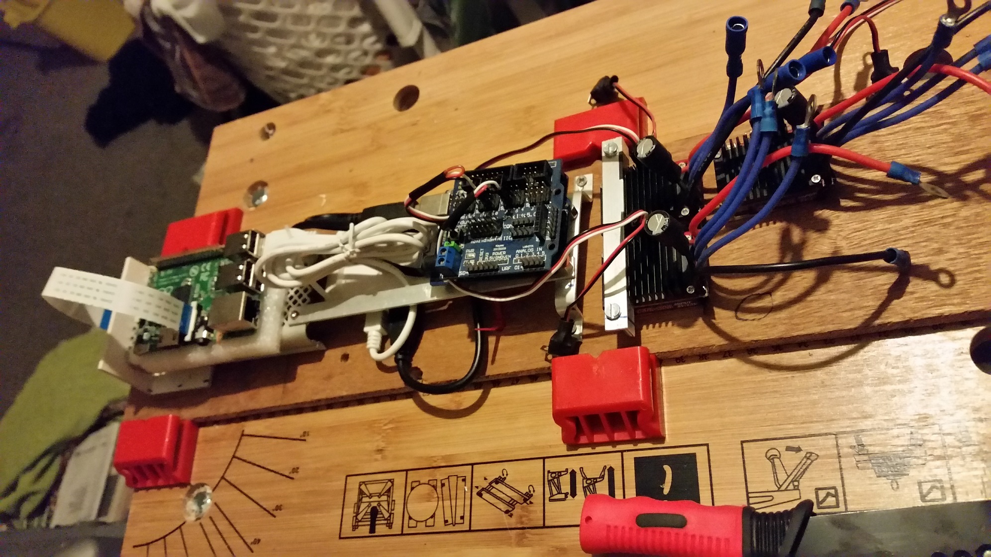

Finally found some time again to work on the ROV and take a few pictures. the hull design is almost completed in my head (always easy) and now I managed to piece together the internals on a board that fits in my hull. The basics are still to reuse material that I have around the house so far so good.
The whole board would fit (1m) but I am trying to make it as small as possible so less then 50 cm. The underside is for the batteries and for the power/network adapter if I manage to repair the fired one :roll:
More detailed overview.
overview of control board.
I created some alu brackets to add an extra level so I could place the cables and USB hub below the Raspberry and the Arduino. Everything is zip-ty and screws because this is supposed to be version one :D
