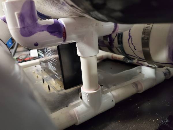

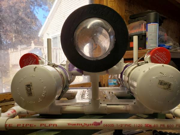

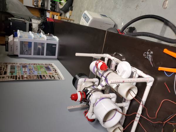

Here is my ROV. Any ideas on how to incorporate something to fit the spot where the battery is without rebuilding? On the electronics forum, they asked if I thought of hooking two smaller lipo batteries up in parallel and sticking them in the tubes. If I went this route I could eliminate the large battery altogether and run multiple smaller batteries in parallel to allow for the "ah" of the original 12v battery. Any thoughts on this approach? Also, I plan to only go a max of 125ft, but will likely not go above 60 - 70 feet often as there are not many lakes near me with a depth greater than 60 feet. The two outer pipes are 3 inches and the center electronics tube is 4 inches. I tried sliding the battery in the 4-inch tube, but the tube is just a hair shy of being able to slide in. This is also my very first ROV, and I am an over-thinker, so I'm just consulting some advice on it. Thanks.bigbadbob wrote:If you put SLA's in a sealed box you could fill it with oil to prevent crushing.

- This is the battery in the dedicated location I made for it.
- phpTa3LOaPM.jpg (26.24 KiB) Viewed 47411 times
- phpT4mcB5PM.jpg (40.01 KiB) Viewed 47411 times
- phprKVQJWPM.jpg (55.16 KiB) Viewed 47411 times

Yes, if you use lippos in tubes you should be fine, I'd still use blow off valves though.
Lippos will be way lighter too and you won't need so much buoyancy if you're not trying to float a lead acid battery.
Best if you can remove the lippos for charging but that may present a sealing problem so If you charge them in the tubes I'd definitely have blow off valves/pressure relief valves/whatever you want to call them.
Personally I don't like putting batteries underwater I like to have them top-side.
but my rov is small and light and doesn't take much power so power transmission down the tether is not a problem if you use 48v or more. higher voltage means less current in the tether. but I digress...
you asked about batteries.
