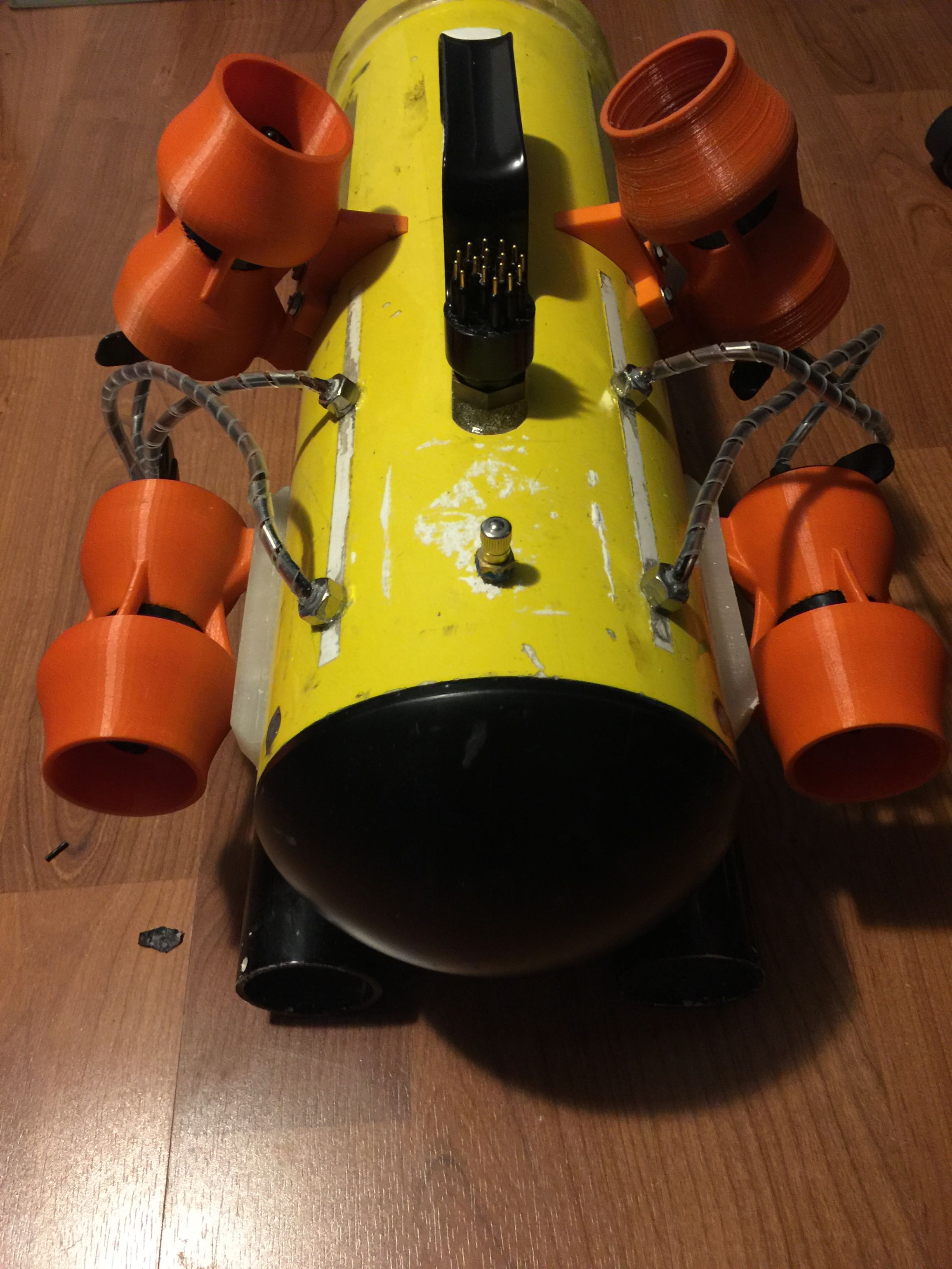

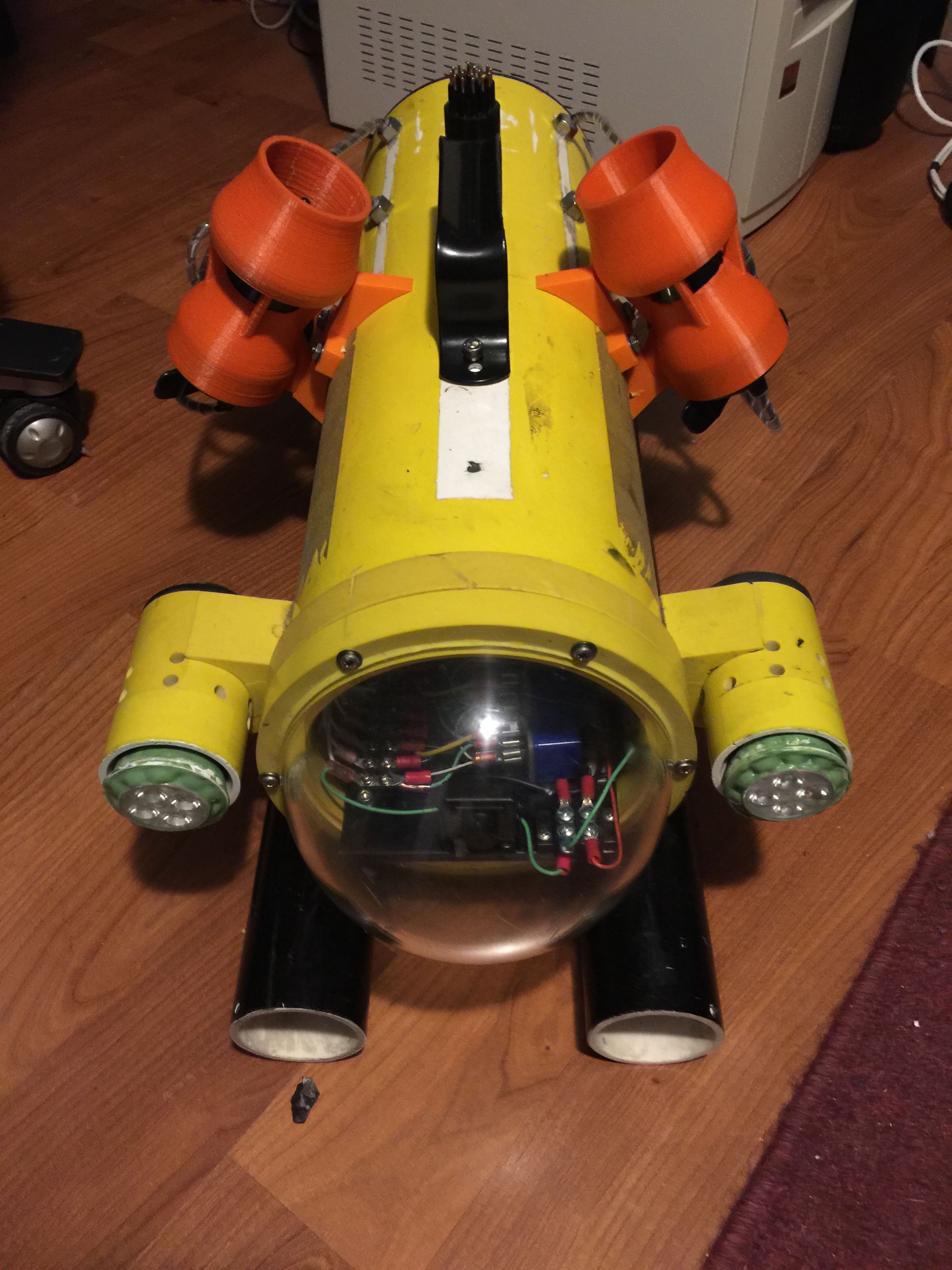

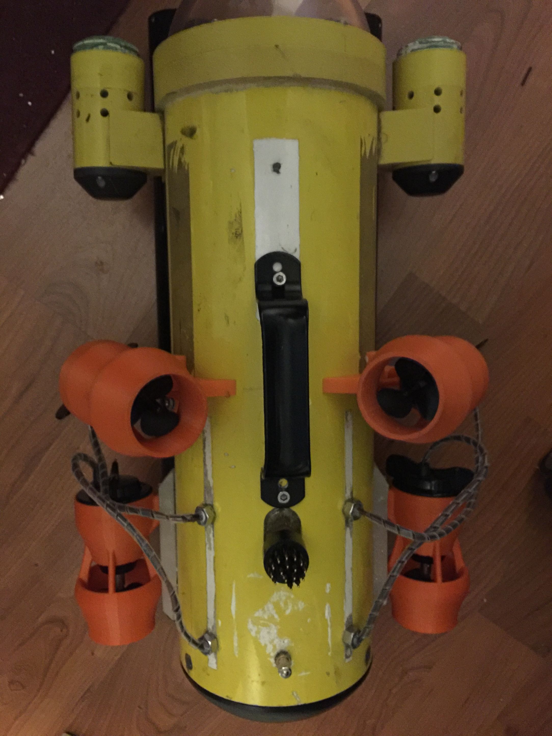

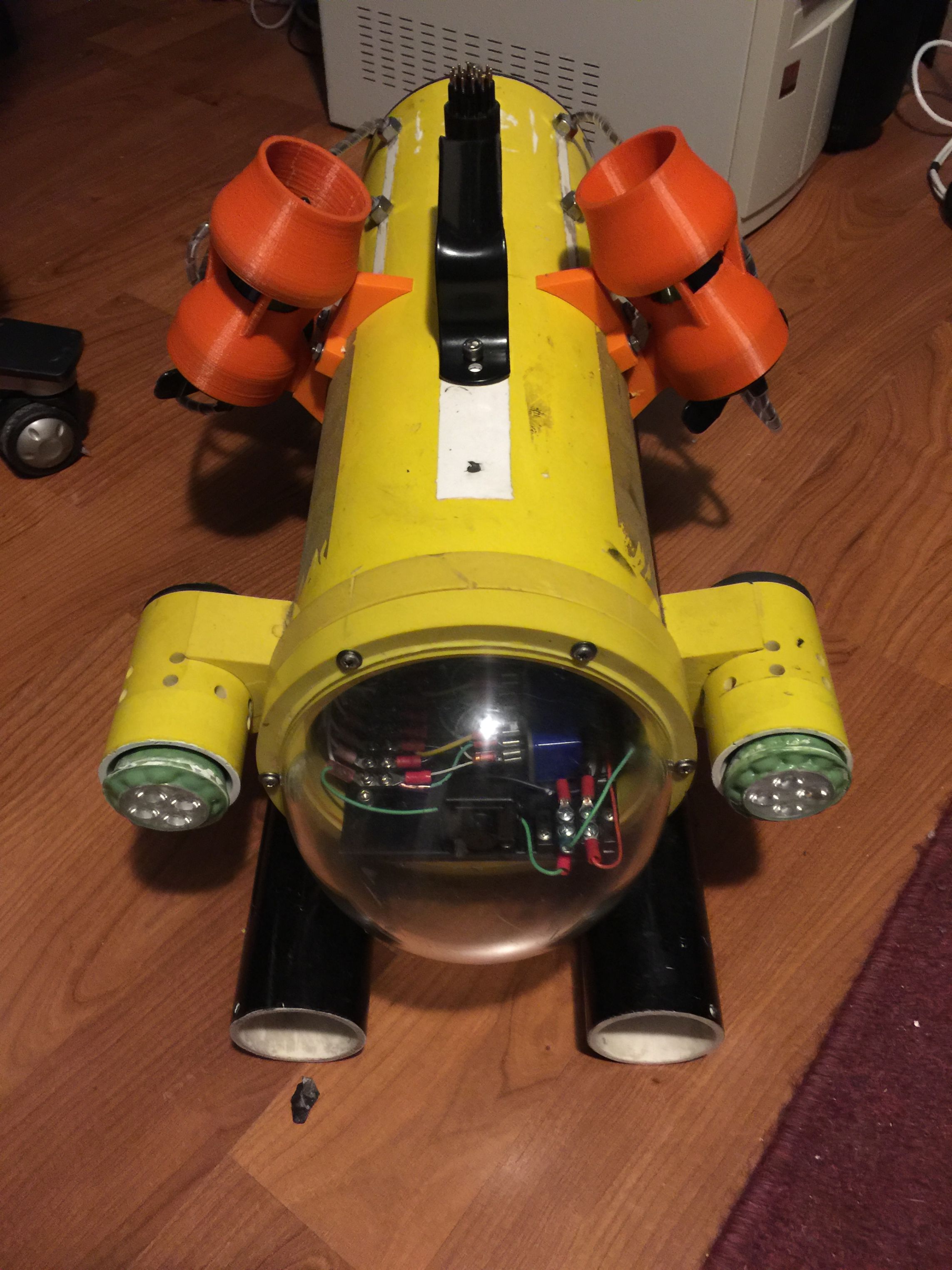

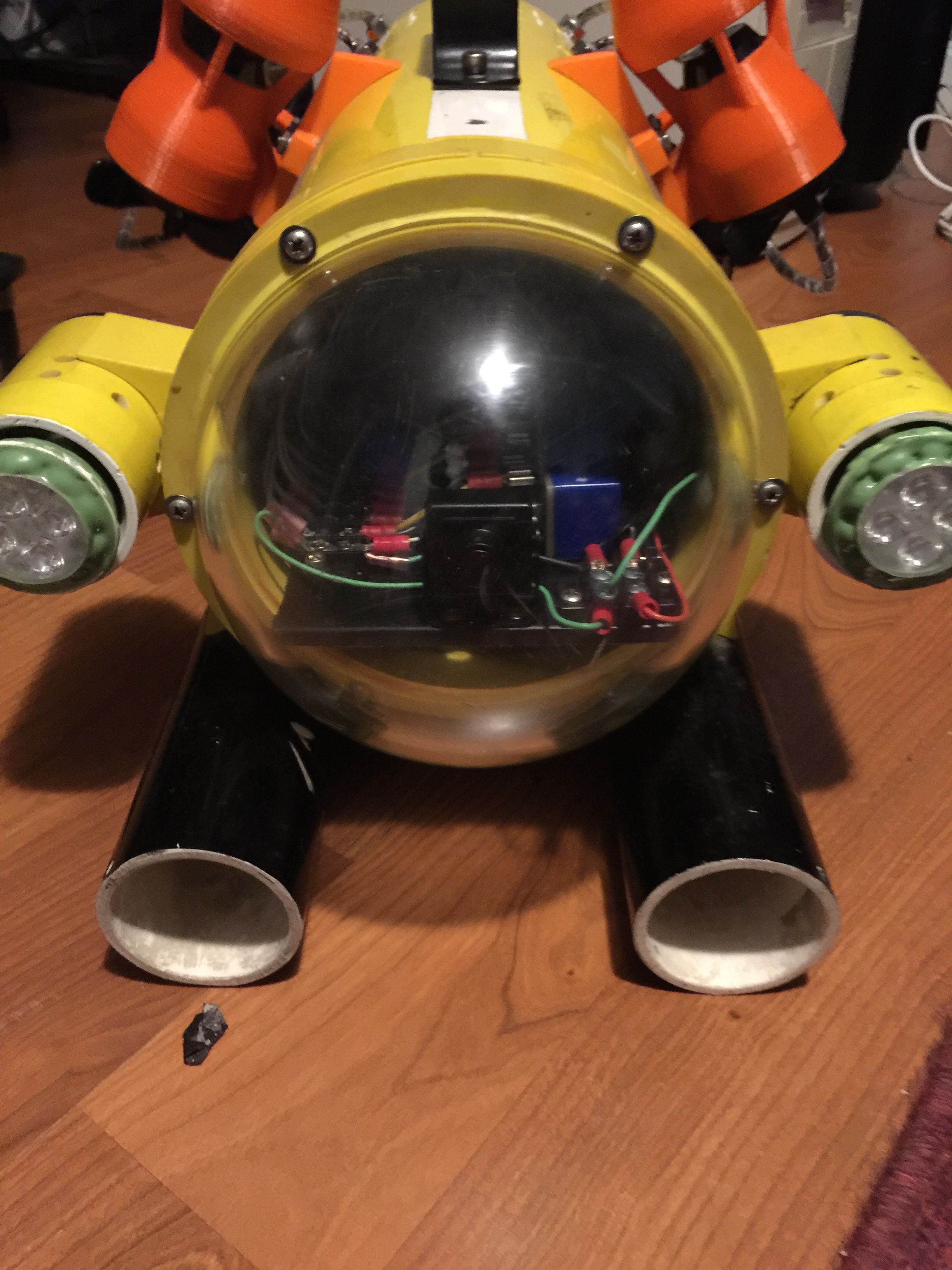

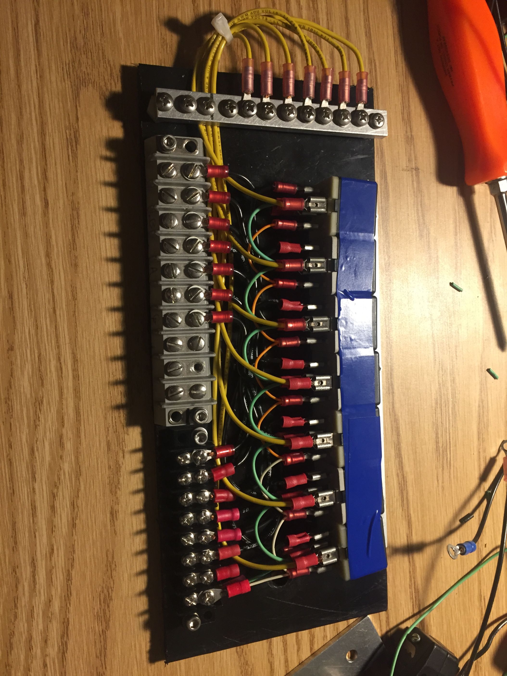

Well, I found this stuffed in my storage unit forgotten about in my land of misfit toys. I dug it out and after a few weeks of ridiculousness, its ready for some sea trials! I made a simple relay board until I get my Ardunio PS2 and motor controller for full digital control board to swap out with.

Nice. Looks like it's aged well. What kind of printer did you use for the kort nozzles?
Re: First ROV
Nice design! I see you are using a professional wet-mate connector for your umbilical. SubConn Micro Circular 16 contact?
Re: First ROV
Looking good... I'm glad to see someone getting use out of those kort nozzles I designed.

@Ian - I really haven't the foggiest on the printer type as I just outsourced it to one of my friends. They came out pretty sturdy so no complaints from me.
@Bennachie - Yup, you nailed that one. I can't stand having an attached umbilical so that was an elegant solution. I dug through the parts pin at work and found a few of those unused.
@sthone - Great design, I always point them your way when they asked where they came from. The prop adapters are titanium. Only thing that was close so the size I needed that was laying around.
I'm using a 12v 7ah battery from a UPS to power everything for now, I just shove it in the back and charge it from the front when I take the dome off. I send 12v down to the relay board thru the tether which is 100' for motor and lights. I'm trying to get a quick claw made up that is fast and dirty so I can retrieve my sunglasses which are on the bottom in 40' of water. The divers at work said they would grab them but I'll try first. My first "Mission".
Camera is in need of a dire upgrade but long as this proof of concept works, I shall try the SJ4000 camera route since it has streaming output capabilities.

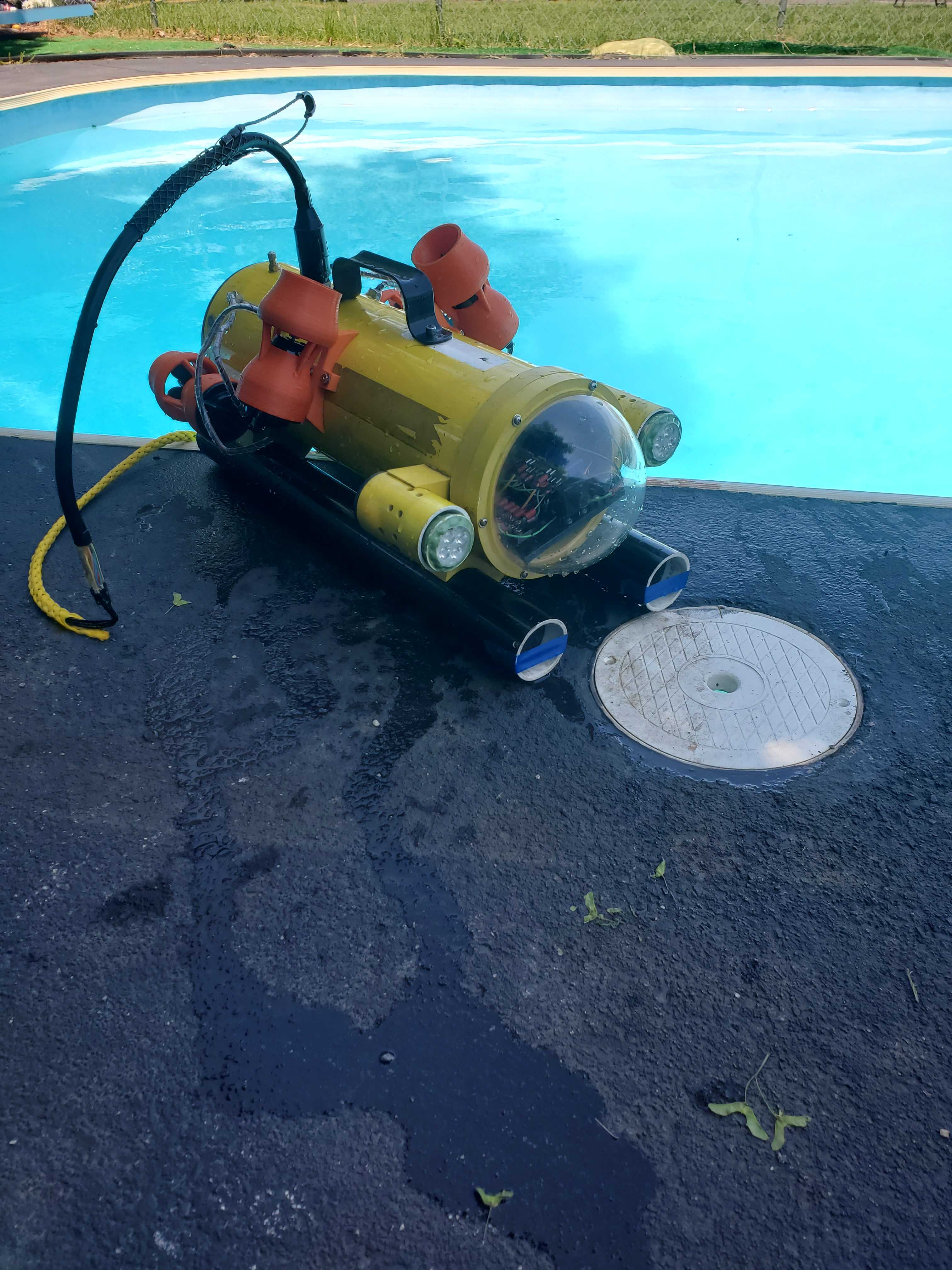

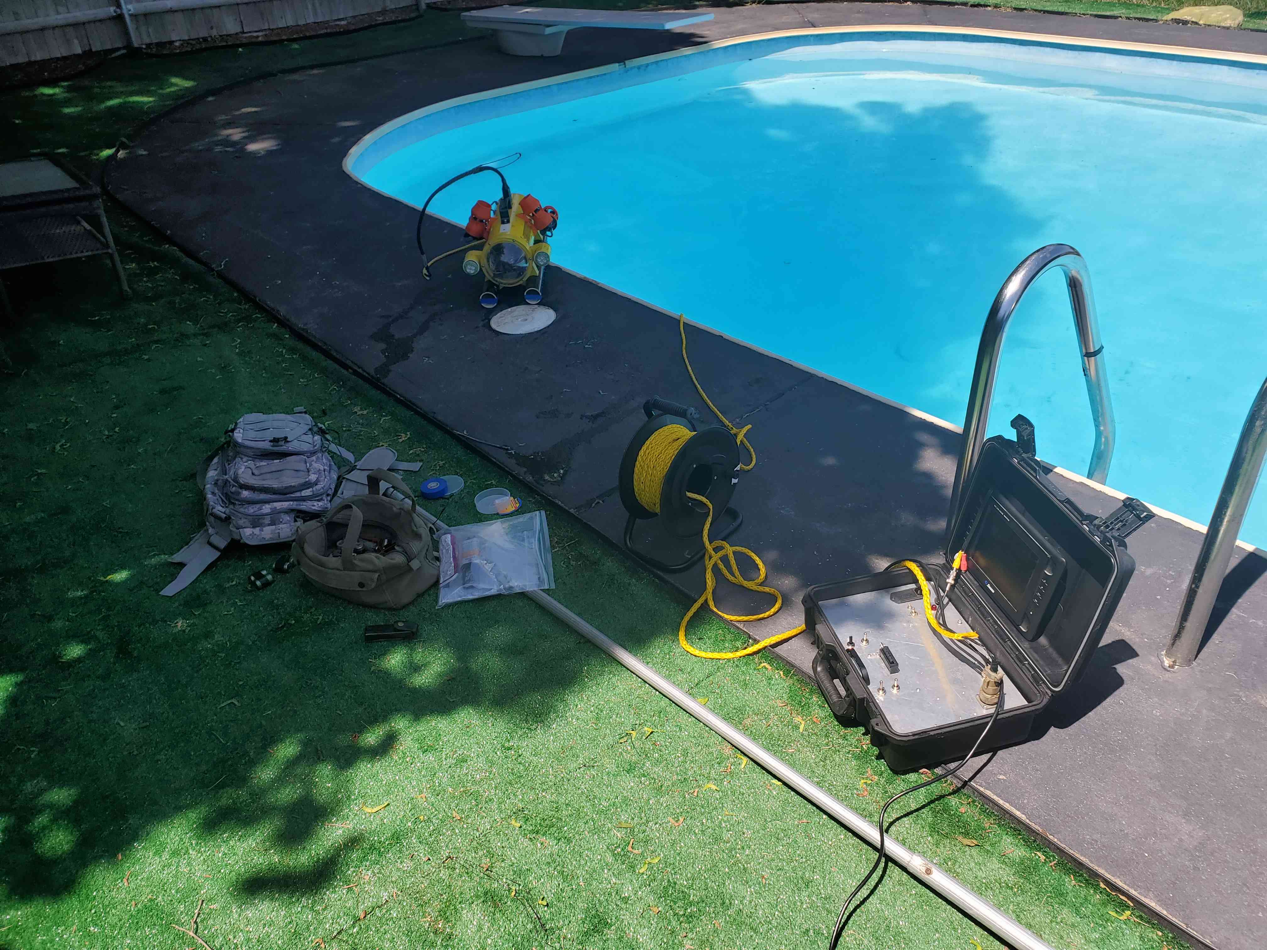

So pool test went well, minus one tiny leak which I fixed, my fault I overlooked a micro gap but a vacuum test quickly found that.
Camera has the feed back quality of a potato, so a go pro rip off that has streaming capabilities will replace that.
Proof of concept works so least everything works as intended. It was A LOT faster than I thought it would be. Makes a nice wake
while running on the surface. Those 3d printed thruster housings worked very well matched with the 3 bladed propellers recommend by sthone.
Hardest part was getting it ballasted correctly. I had to add a good 10 pounds of weight to get it just barely positively buoyant.
I'll get some video up and pictures of it gracefully swimming shortly.
Converting to motor controllers and Arduino's next. Relays and switches work well, but not practical for long term running.
