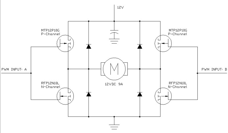

Hi, Im helping to build an ROV for a local competition but have ran into some difficulty. My role is to provide code to help the motors operate. The motors will run off of 3, 2 input H-bridges with mosfets…
How many pwm pins should the rov need per motor? Ive been told from some people that each motor should require 2 pwm pins (Forward & Back), although ive heard from another source that each motor should have 4 pins.

Hi, you should just need two PWMs per motor.
Each PWM signal feeds two of the MOSFETs. See attached diagram.

- H bridge motor driver
- HBridge.jpg (27.01 KiB) Viewed 62935 times
