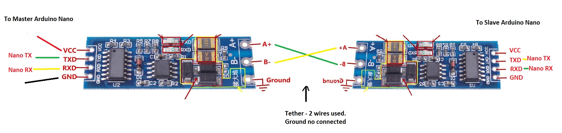

Here is how I connected my Arduino Nano's to the RS 485 modules.
ttl to rs485.jpg (174.47 KiB) Viewed 8012 times

I think there's a mistake in your diagram. For an RS485 circuit, A+ should connect to A+, and B- should connect to B-. There should be no crossover.

I could have got it wrong, I'll check my connections and verify.

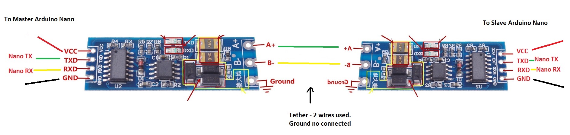

Yep got I it wrong. Checked my connections on the ROV and here is how it is actually connected.
ttl to rs485.jpg (173.15 KiB) Viewed 7990 times
