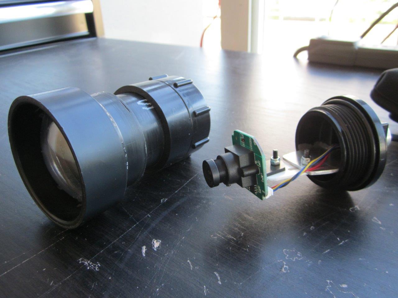

I'm mainly not sure how I can make the camera waterproof while still giving the camera full visibility in the water. I thought of some ideas to make it waterproof, mostly by using threaded PVC, but I'm not sure if this is the most practical way. If I can find an action camera that has a waterproof case with hdmi access that I can buy then I will be set.

This is PVC fittings from Home Depot.
ROV camera 006.jpg (114.46 KiB) Viewed 48641 times
