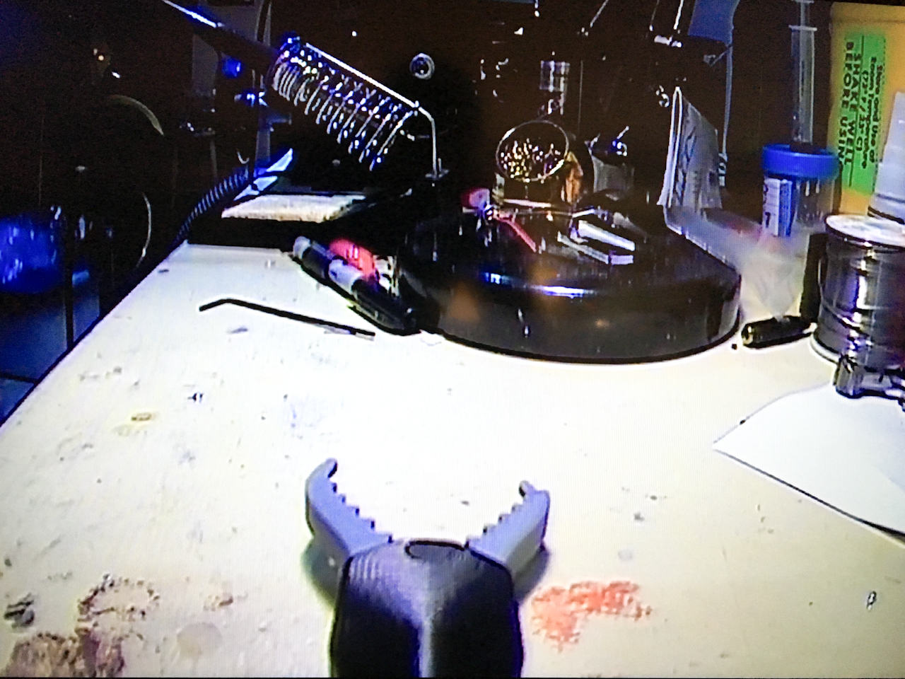

Well I got everything wired up and everything still works... the view shows whats next. :P

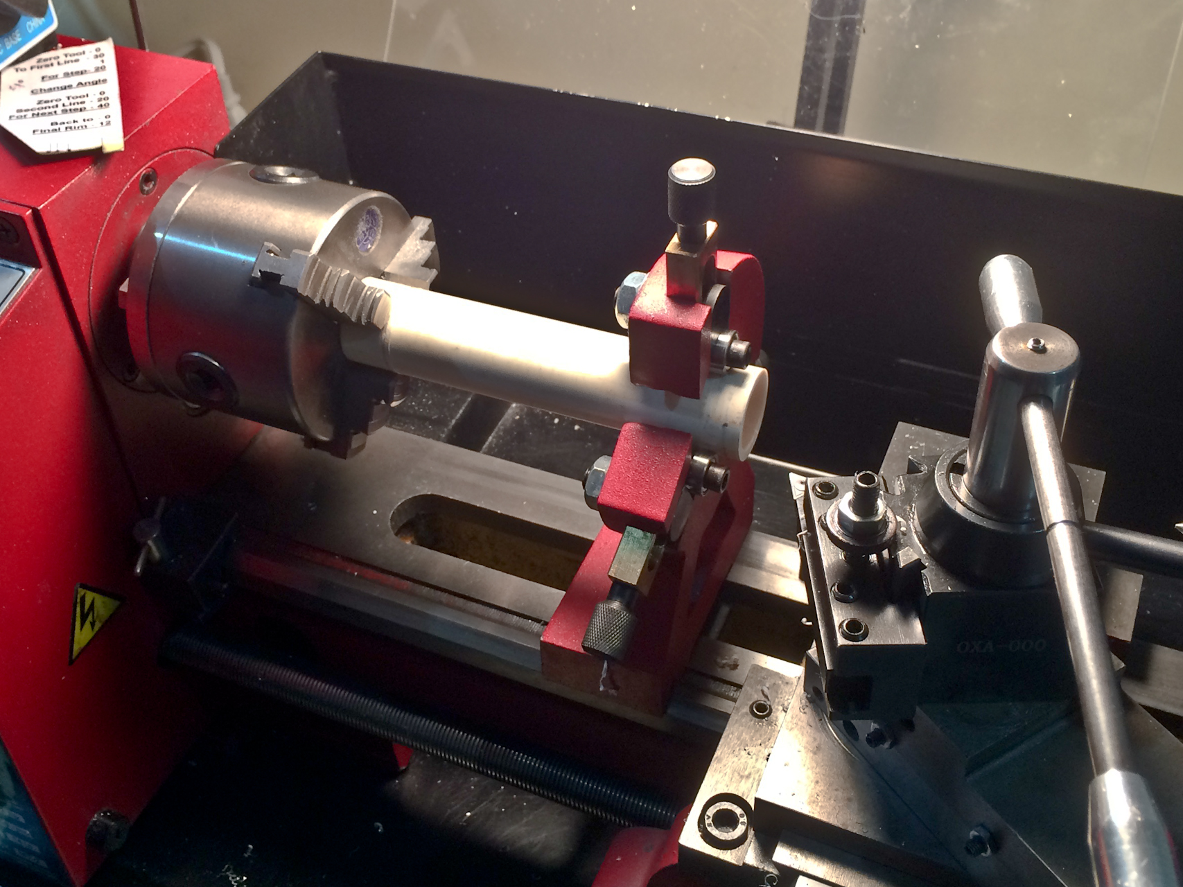

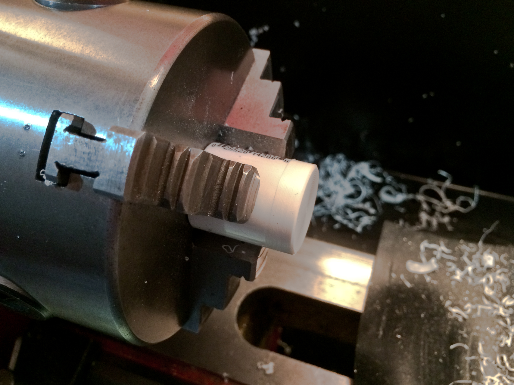

I always get emails on how I went about making the manipulator for the Seafox so I'll try to give a break down of how this one is made as I go. It does require machining some of the parts so a small lathe is required.

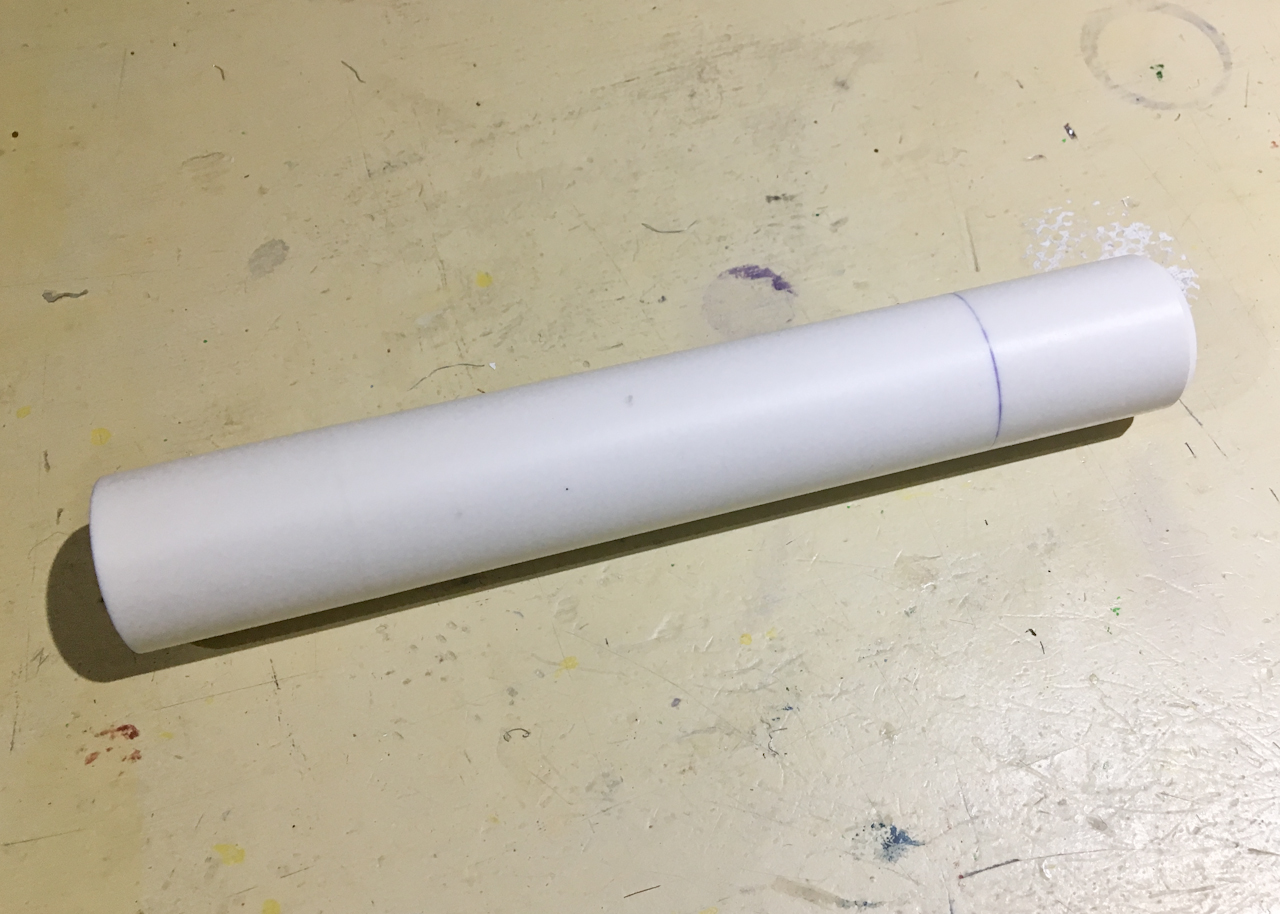

For this one I started by squaring up the ends of a piece of 3/4" PVC Pipe.

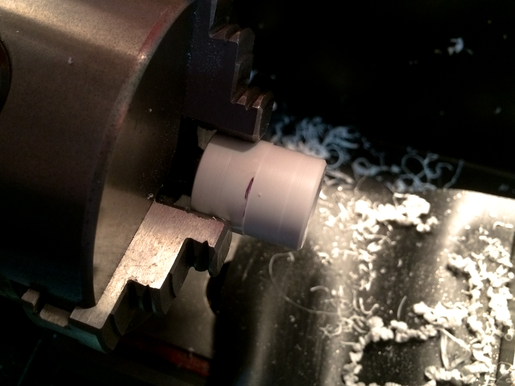

Next I trim off a small section of a 1/2" PVC Coupler. (This will be the front section of the main arm housing.)
Then I turn the coupler around in the chuck and chamfer an angle on the front edge. (This is purely for aesthetics.)
Next its on to the seal seat piece. I start by trimming off the flange of a 1/2" PVC Plug.
I then drill and bore out an area to create the seat for the actual seal.
Turning that part around in the chuck I have to turn it down just a bit so it fits inside the 3/4" pipe.
These are the machined parts so far.
The seal is pressed into the seat at this point. I'm using a 3/16" shaft so this is a 5mm Yamaha motorcycle oil seal. (I'll have to find the part number and update this later.)
Using a PVC primer and glue the seat piece gets glued into the pipe (seal facing out) and then the front section gets glued onto the seat piece. (I couldn't take pictures while assembling it because I need to stick the pieces together while the glue is fresh.)
This is how the seal should look.
After that the assembled piece goes back in the lathe just to clean them up.
The main housing all cleaned up and I'm ready to work on the internals.

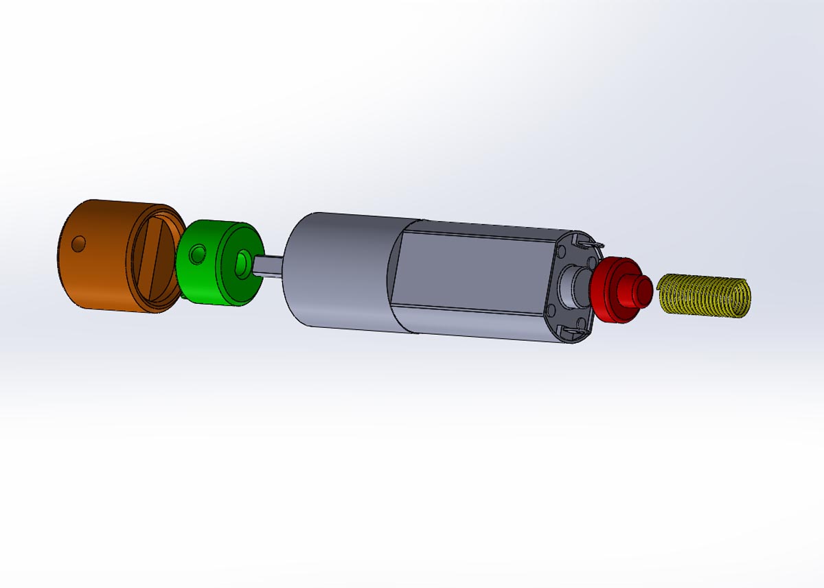

This is an exploded diagram of the Internals.
Colored parts explanation from left to right.
  • Purple/Grey part is the seal/seal seat part that was glued into the main arm housing.
    Yellow is a bushing to hold the shaft centered (I didn't feel a bearing was needed on this one.)
    Orange is the shaft side of the slip coupler.
    Green is the motor side of the coupler.
    Grey is the 10 RPM gear head motor.
    Red is the spring cap (this holds the spring centered and away from the motor terminals.
    Next is the spring.
    Light blue is the internal motor housing.

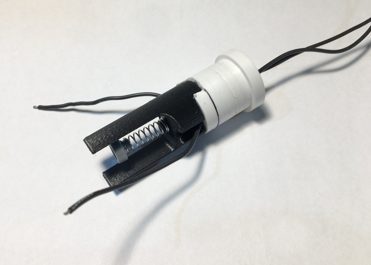

Here are the actual 3D printed pieces ready to be assembled.
This shows how the spring cap keeps the spring centered and away from the terminals and wires.
The two halves of the slip coupler. The amount of force required for the coupler to slip is depended on the spring used. (I used a ball point pen spring.)
Once everything is assembled in the internal housing the bushing will be glued in place. The bushing slip fits into the seal seat piece when assembled.
The entire internal housing then will slide into the main arm housing and be held in place with a end plug. (not shown yet)

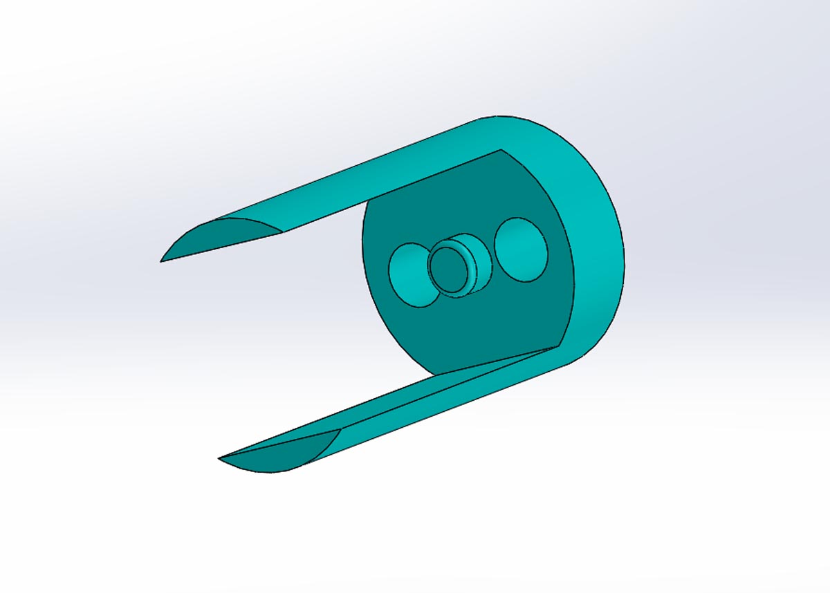

Re: Rov Reboot (3D Printed Rov)
Ok that was easier than I thought... Here's the redesigned motor mount. It's no longer a complete internal housing and the flat sections are going to be real thin but I'm still hopeful it will work out.
Everything looks pretty much like it should still fit and work out. I just have to print a the new mount and a new spring cap before I'll find out for sure.

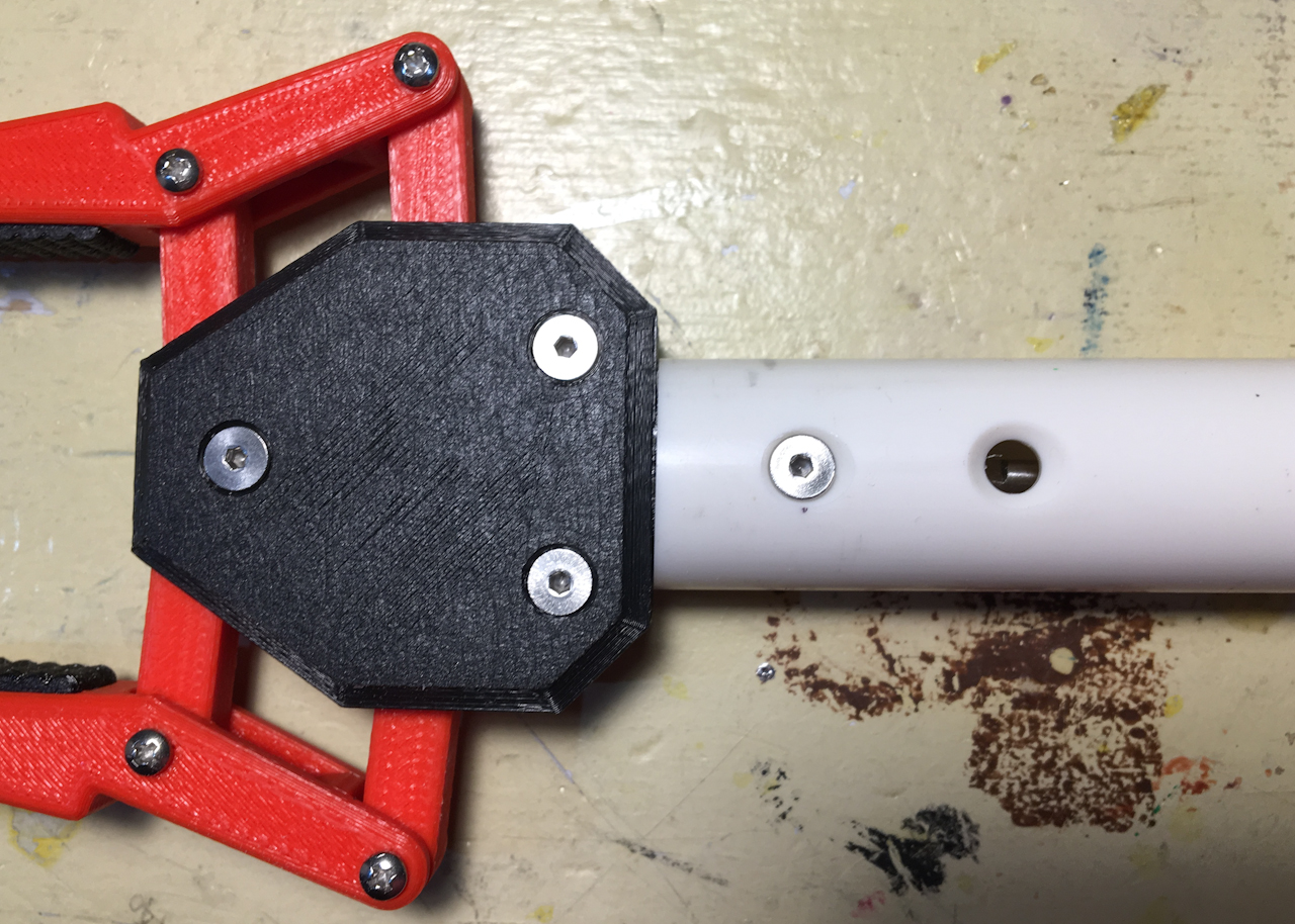

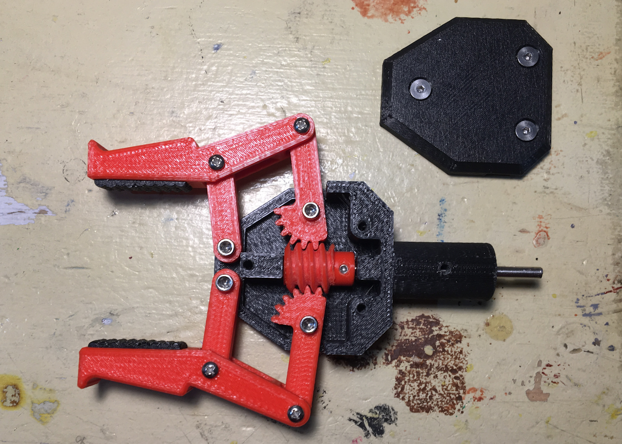

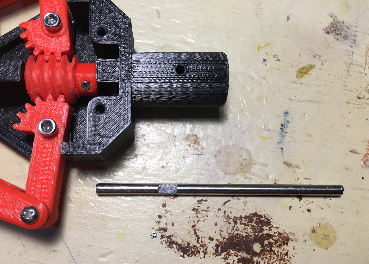

Here is the other printed gripper. Everything was printed in PLA with the exception of the pads on the fingers. I printed these out of a flexible rubber material so they would have better grip. It uses some 4-40 and 2-56 screws for assembly and a 1/8" stainless steel rod for the gripper shaft.
The gripper shaft has a flat spot ground in it for the 4-40 set screw on the worm gear.
This smaller shaft of the gripper will mount to the motor shaft though a coupler. This will allow the grippers to be easily changed out when needed.

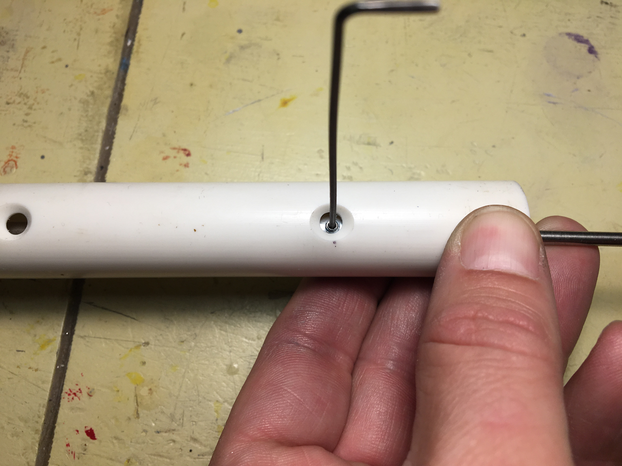

I next cut a 6" long piece of 1/2" PVC pipe to use as the arm of the manipulator. Using the gripper assembly I mark the location of the mounting holes for the gripper. The first mark is for the mounting screw and the second mark will be the access hole for the coupler set screw.
After drilling several holes through the arm on both the top and bottom the arm is glued to the motor housing portion of the manipulator. (some of the holes are for drainage because the arm portion of the manipulator is not water tight.)
A quick test fit of the gripper is next to make sure the set screw access hole is in the correct position.

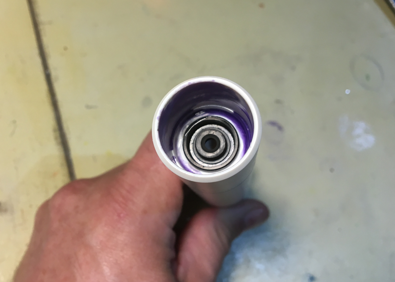

I am using a piece of 3/16" stainless steel rod for the motor shaft. Again a flat section is ground into the shaft for the shaft slip clutch coupler set screw.
Next the bushing is placed on the shaft and the shaft is inserted into the housing and through the seal.
I then mark the center location of the set screw in relation to the motor shaft.
I made a coupler out of aluminum to join the smaller gripper shaft to the larger motor shaft. I then mark the location where the motor shaft needs to be cut as well as how far in inserts into the coupler.
After cutting the shaft to size and grinding another flat on that end (not shown) the shaft is reinserted into the motor housing. I temporarily attach the coupler to a scrap piece of the gripper rod so I can insert it into the arm and affix it to the motor shaft.
I secure the set screw in the coupler to the motor shaft through one of the holes in the bottom of the arm.
With the motor shaft and coupler in place I can go back and trim down the gripper shaft to length and grind the set screw flat on the end. (this is done with the shaft removed from the gripper)
Then is just a matter of sliding the gripper in place, securing it with a 4-40 flat head screw, and tighten the gripper shaft to the coupler.

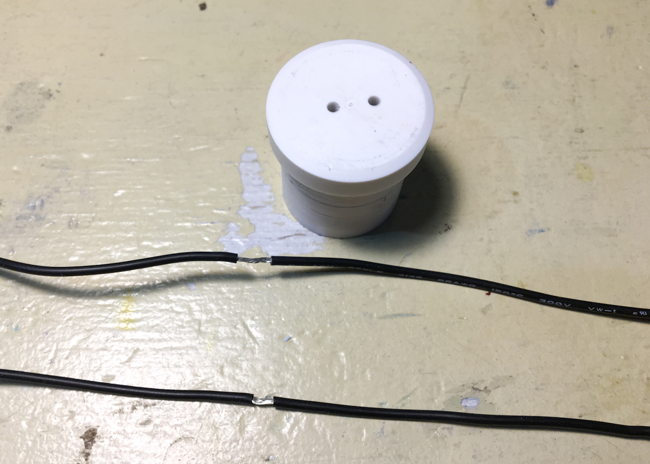

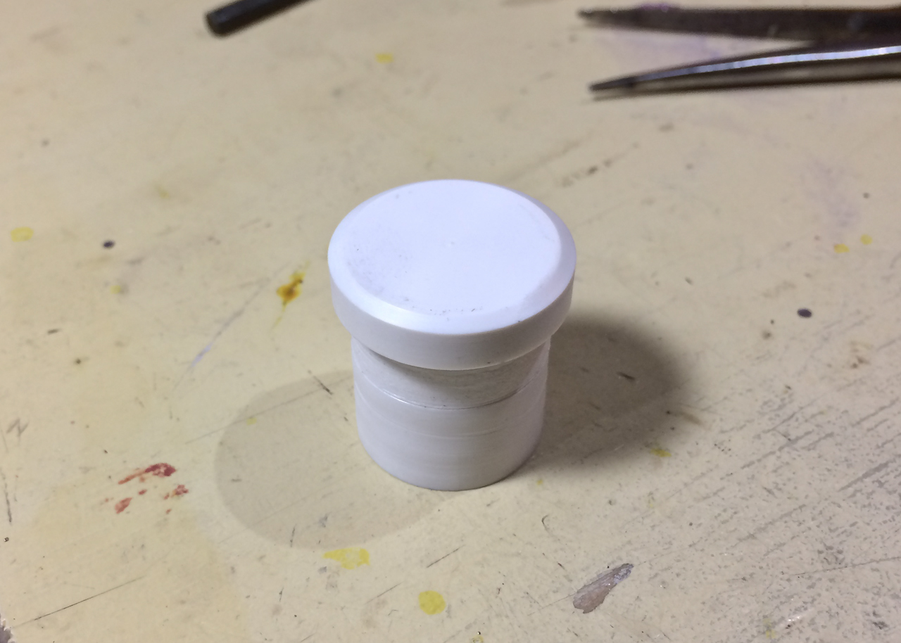

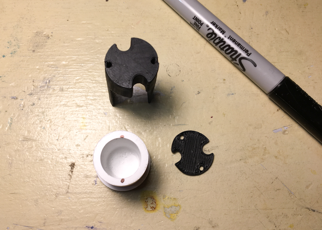

Next is was on to the end cap. This is another 1/2 Plug that is turned down to fit inside the 3/4" Pipe.
My original idea to keep the motor from rotating was just to use a couple of pins to attach the motor mount right to the end cap so I made a template to dill some holes in the edges of the cap.
This Rov is not going to deep so I just use the epoxy method of sealing the through wires. (I did strip the section of the wires that will be in the epoxy to combat any leaking through the wires jacket if it gets nicked.)
Here the epoxy is setting up. (I finally found a use for the larger manipulator I printed years ago. :D)

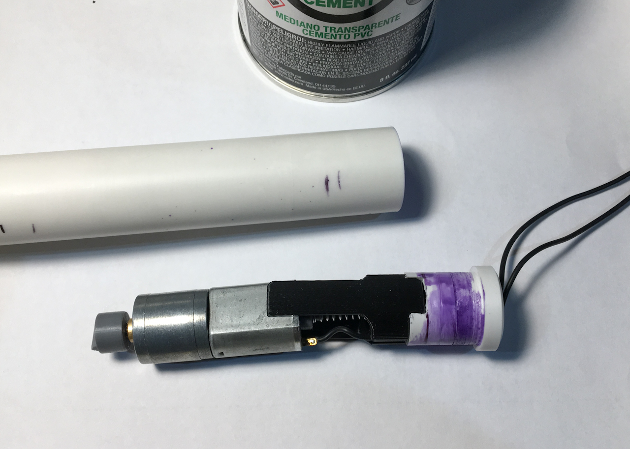

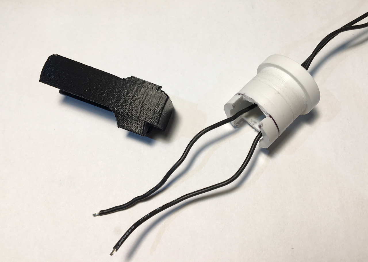

The pin idea ended up looking a little sketchy so I ended up cutting a section out of the end cap and redesigned the mount to have a mating surface so it should be stronger now.
Here's how the mount and end cap go together.

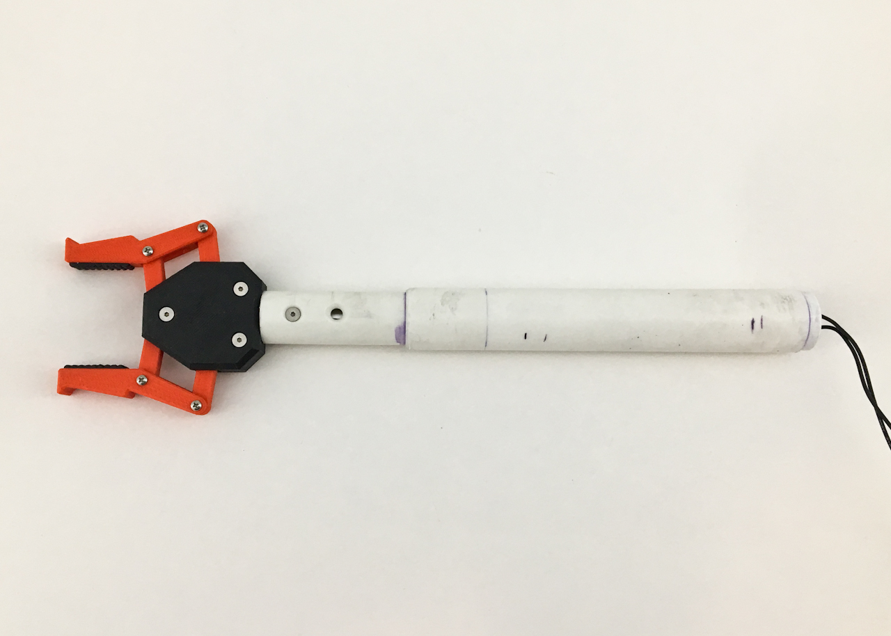

I cut the wires just long enough to leave room for the motor to slide back and forth a bit. After soldering them on the motor its time to put this thing together.
Here's the scary part about this... once the end cap is glued on there is no going back. There is no fixing any problems and it's pretty much a disposable housing if anything goes wrong. (Which is why I didn't want to risk just using the small pins to keep the motor from rotating.)
Here is the assembled manipulator... as you can see I changed the length of the arm too. When mounted to the Rov it would have stuck out to far and I want to keep the Rov relatively small.
So far everything is working, here is a quick GIF of it in action... It's still kind if slow (I think a 60RPM motor would be better but I couldn't find one small enough.) The grip isn't the strongest either because of the slip clutch but its better than stalling the motor every time it closes to far.

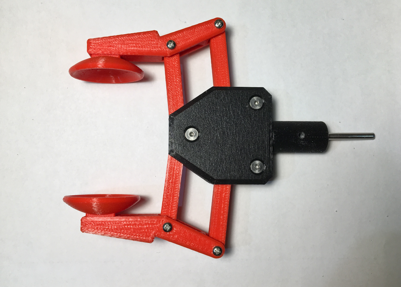

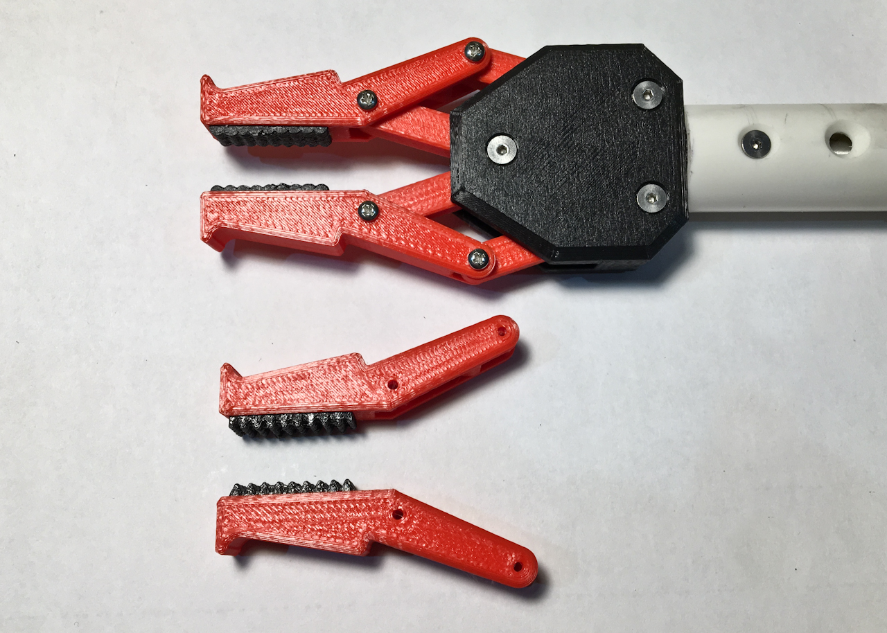

I printed up some different fingers too with optional finger pads. The top fingers (mounted one) have round tip pads while the bottom fingers have pointy tip pads that might grip better. I still need to run some test to see what works better.
Here we have the golf ball grabber. This one actually has a wider opening which I could use the other fingers on if needed.
