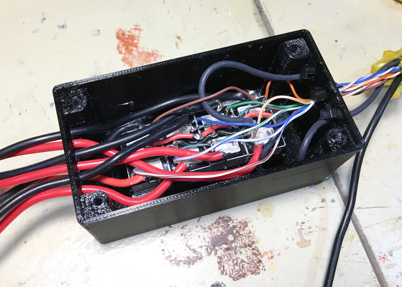

It's been a long time since I've worked on this but I'm trying to get back into it. Something happened to my control system since the last time I tested everything and I couldn't get it to work right so instead of wasting time tearing the old one apart I just decided to redo it from scratch. I started by designing a new projects box and then 3D printed it in PETG so it would withstand the heat of the wax waterproofing process.
I used four of the H-bridge relays I use on the Seafox just because I know they can handle the amps of the bilge pumps. (I'm not sure if one of the relays I used last time crapped out or what... it worked when I put it away.) The projects box was designed to hold these four relays securely in the center.
It's not my cleanest solder work as I rushed everything just to get going again. I added quick disconnects to the thruster too just encase I had to redo it again in the future I could easily just swap it out. I didn't take any pictures of the wax poring process as I've gone over that before in the The Basic Rov Control System Wiring Manual.

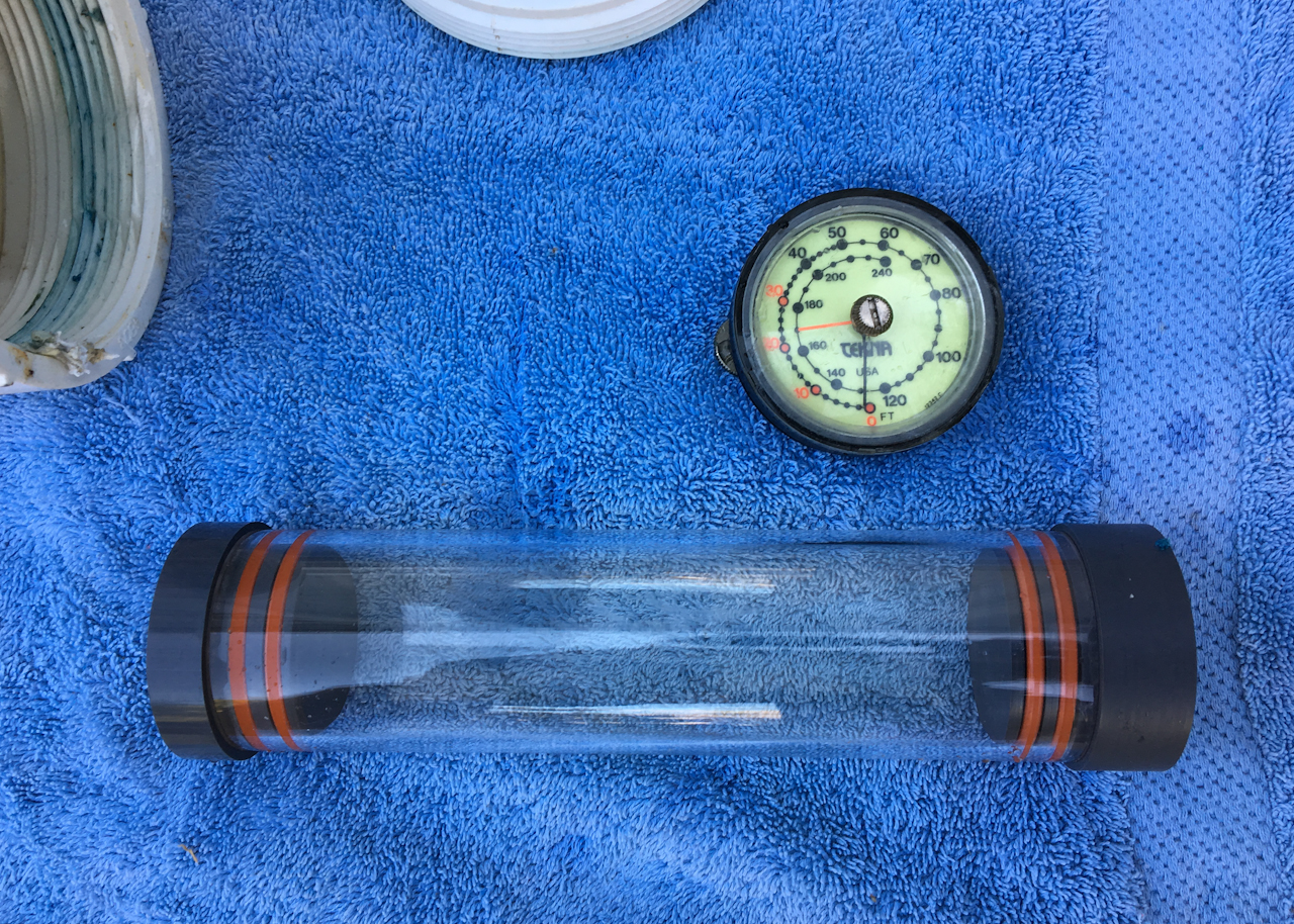

Found the time to start the other camera pod end cap today and I did a much better job this time cutting the channels for the o-rings. I found a guide online and was able to figure out the proper depth they should be this time. They still might not be perfect yet but at least I can remove this end cap unlike the last one. I still have a bit more machining to do to this cap but I'm going to try and get it in the pressure chamber tomorrow and give it a test to see if it's waterproof before I go any further.

I dug out the old pressure chamber today to test my caps out... unfortunately my PSI gauge was messed up (it reads 20-30 PSI) with no pressure so the 100PSI reading shown here is not correct. I do however have a scuba depth gauge so I threw that in the chamber with the camera housing.
The first tests were a success as there was no water in the housing. The max depth on the gauge showed right around 170' which should be in the neighborhood of 70-80PSI which is about right for house water pressure. This Rov will never see that depth so I should be good with the seal the o-rings are providing.
Next I have to machine out some recesses on the one end cap and drill some holes for the through connectors for the 5 wires. After that I will have to re-test in back in the chamber before installing the actual camera. Overall things are going well and it feels great to be making progress on this project again.
