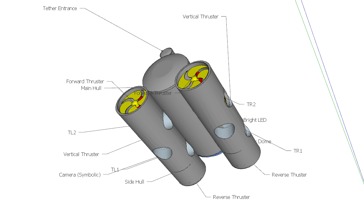

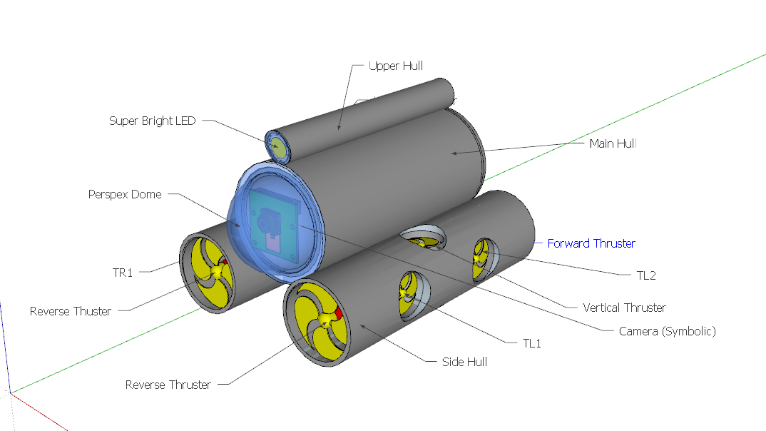

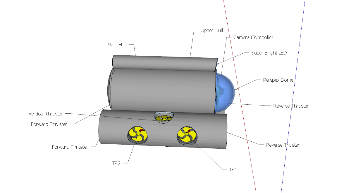

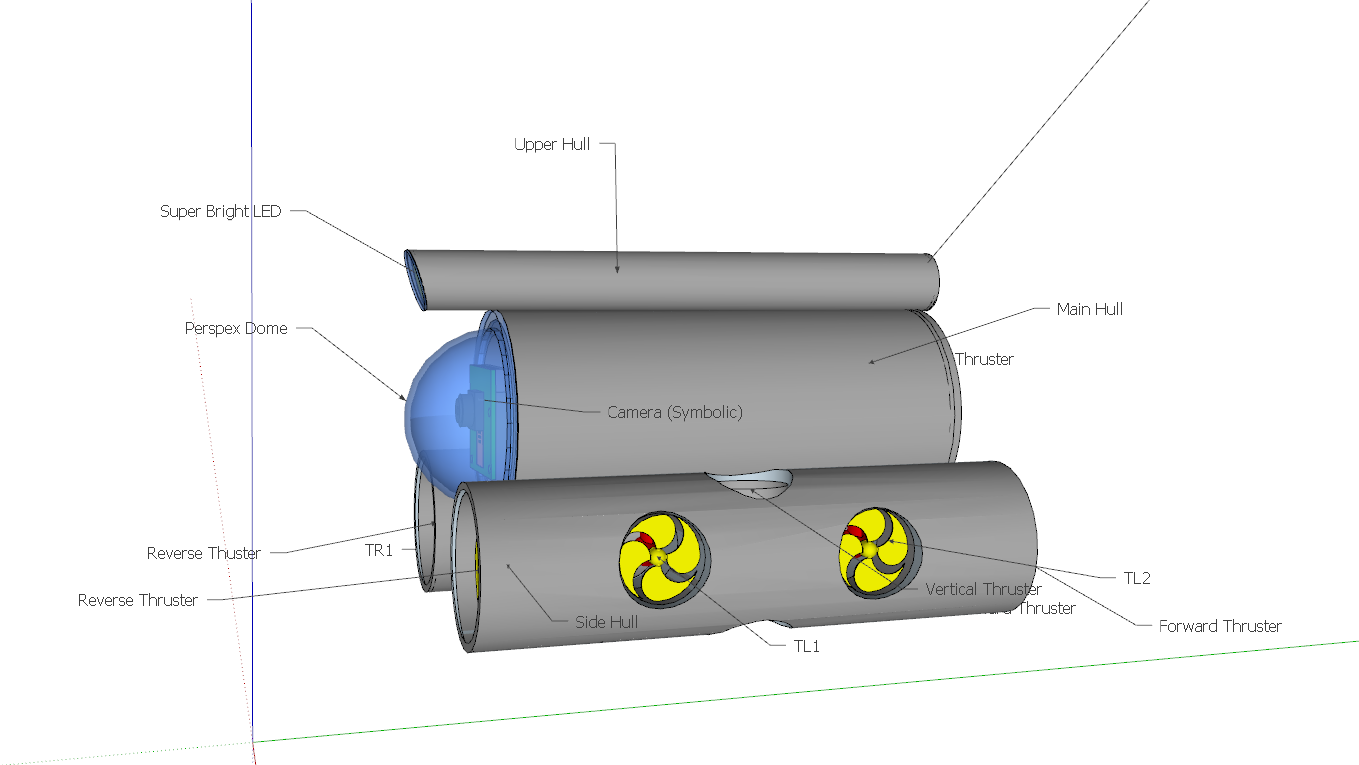

I've decided to finally stop browsing this forum dreaming about building an ROV and instead to actually start designing the thing. I've finally managed to wrangle a very simple design out of SketchUp so that I can visualize problems and solutions. I've decided to post the pictures of my design here as there is a wealth of knowledge from you guys who have been doing this for years and I'm sure there are many flaws in my design.
The ROV will steer left using TR1 and TL2 and right using TL1 and TR2. It will strafe using the side thrusters and will hopefully be slightly buoyancy positive.
Any feedback would be greatly appreciated.

You should replace the LED. In this position it will cause glare in your dome.
Maybe a bit more to the front or better two lights, one on each side. As far away from the dome as possible.
You are on a good way. Can´t wait to see some pictures of your build!

Thanks for all of your positive replies and comments. In response to your suggestion ArduRov, I've moved the upper hull forwards so that it is almost infront of the dome, which should stop there being glare in the dome from the LED. I now need to find some PVC pipe that doesn't cost a small fortune!
