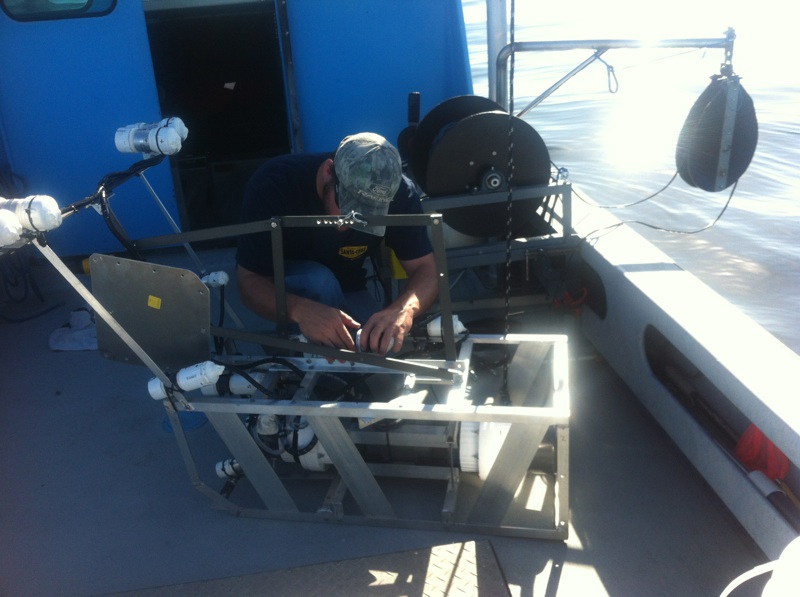

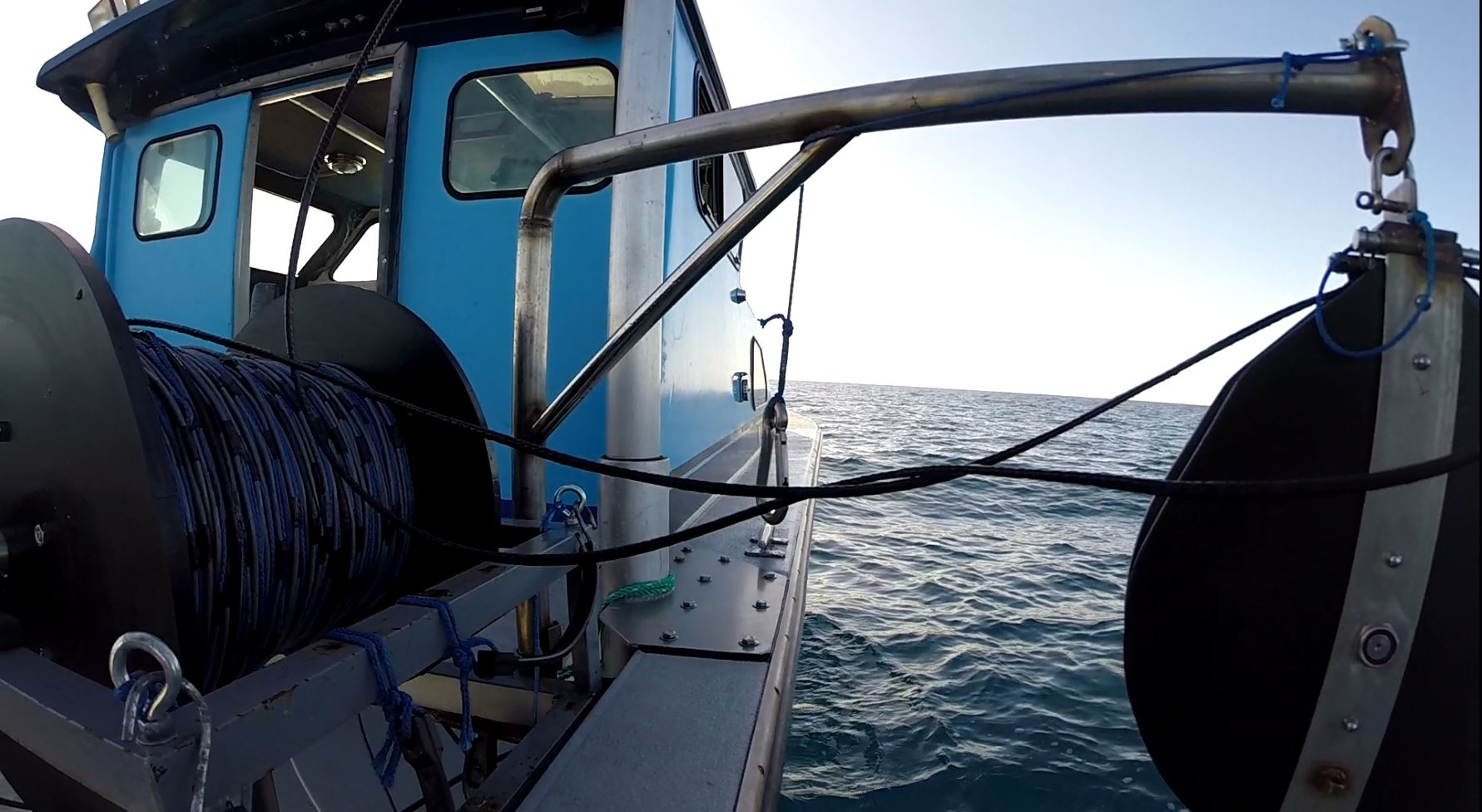

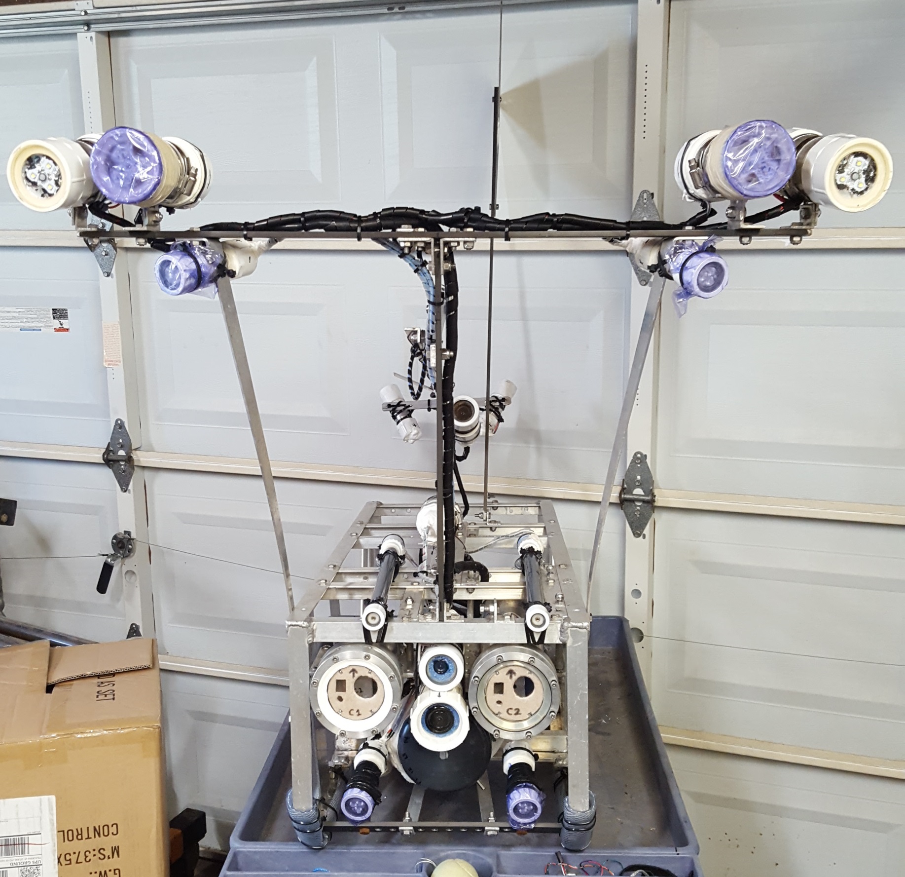

I almost forgot to show a few pictures of the camera itself, and the winch. I plan to make a video showing some of the details of the camera, winch, and how it all works pretty soon.
