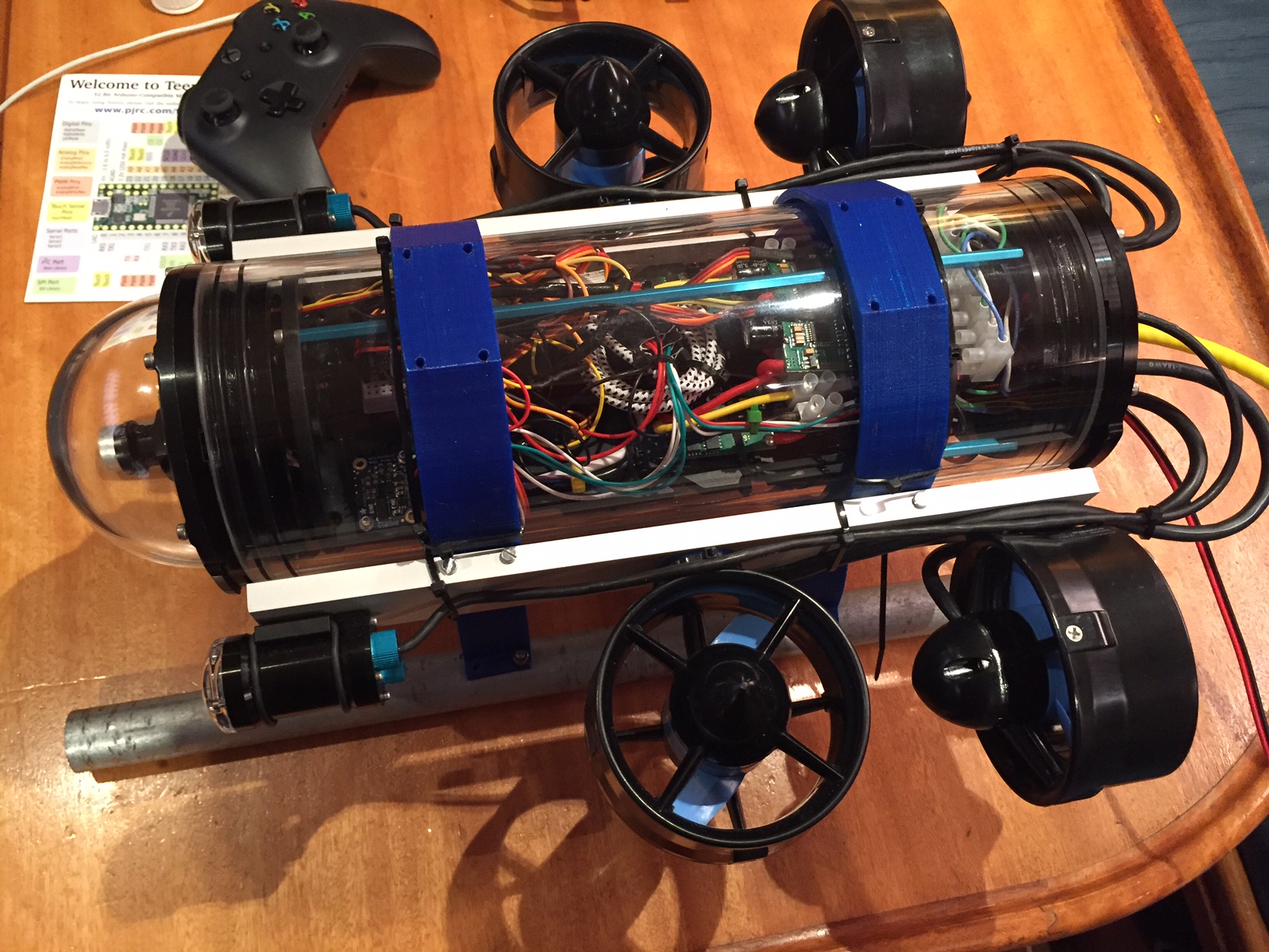

Got any pictures?
Moki
Posts: 119
Joined: Oct 21st, 2014, 2:19 am
Location: The Netherlands
Re: Raspberry PI based ROV (with Arduino)
Post by Moki »
Ian MacKenzie wrote:Got any pictures?
Not a recent one, but here is an old one.
The looks didn't change much... using the same code.

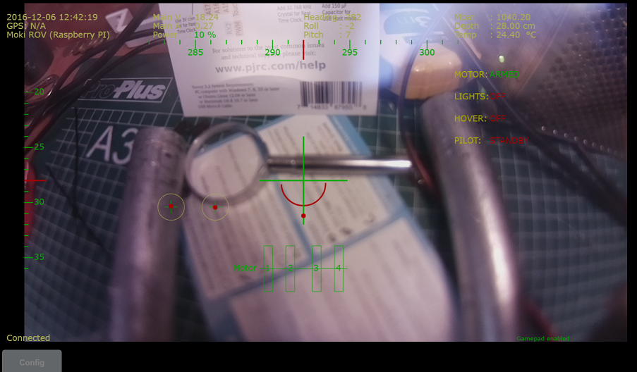

And a recent screenshot :D

Post by Moki »
And the Moki ROV2 (but thats off topic)
