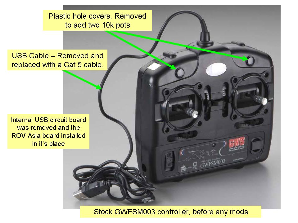

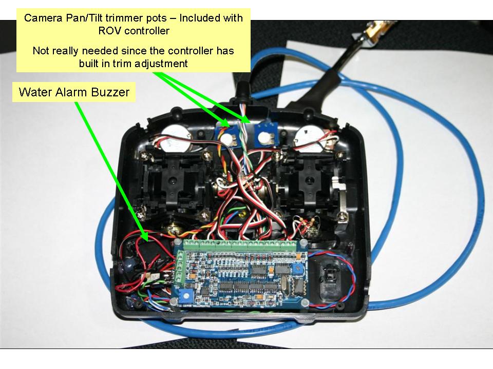

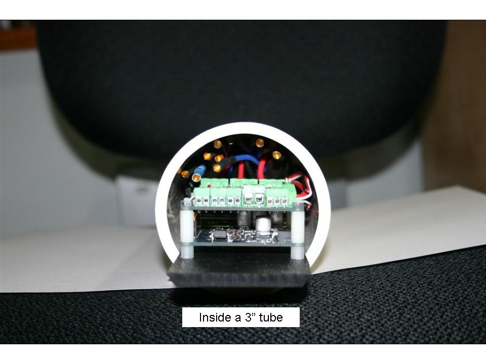

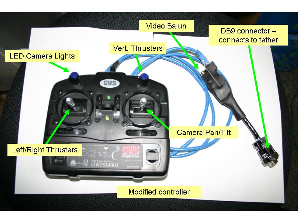

Hi Guys. I also purchased the ROV-Asia controller and really like it. It's compact and nicely laid out. The FWD/AFT and LEFT/RIGHT thruster algrorithim works nicely. I un-stacked the light controller board, so it will fit in a 3" tube.
I like the varible speed control you have with the system, and the trim levers allow you to trim everything out on the fly.
The control also has 3 LED's to indicate topside power, ROV power, and water alarm LED
The control board controls the brushless out-runner motors smoothly. The reason, I went with out-runners, is they come in lower KV rating (throusands of RPM per volt) I am running 890KV's turning a 50mm prop. And the two vert thrusters are 40mm. Great thrust will lower current draw.
The left and right verticle thruster ESC's are both connected to the vert thrust control signal off of the control board. Works great.
A micro sized servo, also driven by the control board will control the camera tilt. The video feed is through a balun and one twisted pair.
The contol system is built into an RC airplane control simulator.... you can buy them on e-Bay and Amazon. I took out the USB control board, and fit the ROV control board in the battery comprtment area.
As you can see, you end up with a really clean looking controller.
The rest of the ROV is coming along, motors have been tested, pressure bulkead has been pressure tested, tether is built. Hull and lights are ready for assembly.
Jim
