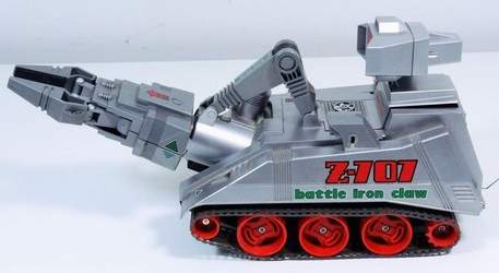

I was searching around for possibilities for a manipulator to use on my upcoming ROV build. I looked at Super Armatron as I've heard of some good success with those arms. Then I came upon this one. I don't see a reason why it wouldn't work with a little modification. Any ideas?
Re: vintage style manipulator
I've hacked up and used the original Armatron for a manipulator and if this one is similar the gears for the fingers are probably spring loaded. I removed the springs and glued the gears to the fingers but the worm gear will still pop and skip on the other gears if you try to close them too tight. This was built into the design so you could never strip any of the gears. While it will probably work just keep in mind it won't have that tight of a grip.
Post by ssrc30 »
That setup should work perfectly fine then as I'm not planning to do any major lifting. My rov will mainly be for a local environmental study on the pollution in local waters. The most I'll be lifting is maybe a pop can that someone threw in the lake. My biggest focus is going to be on video evidence.

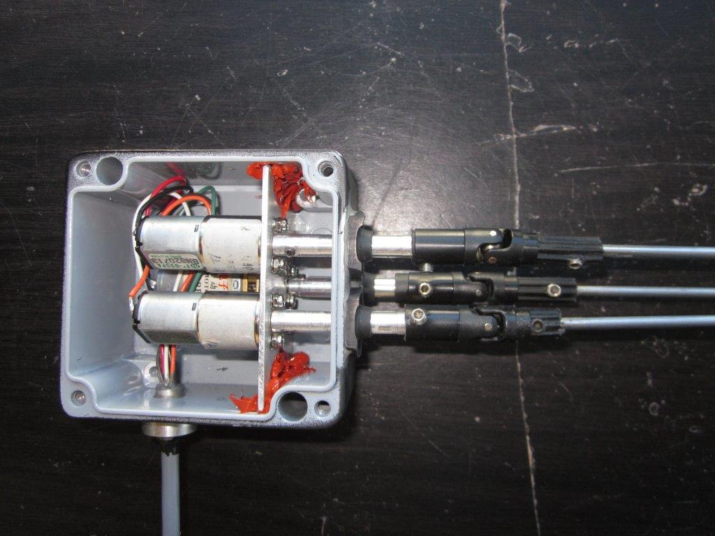

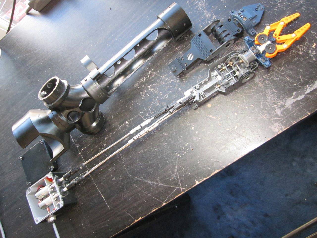

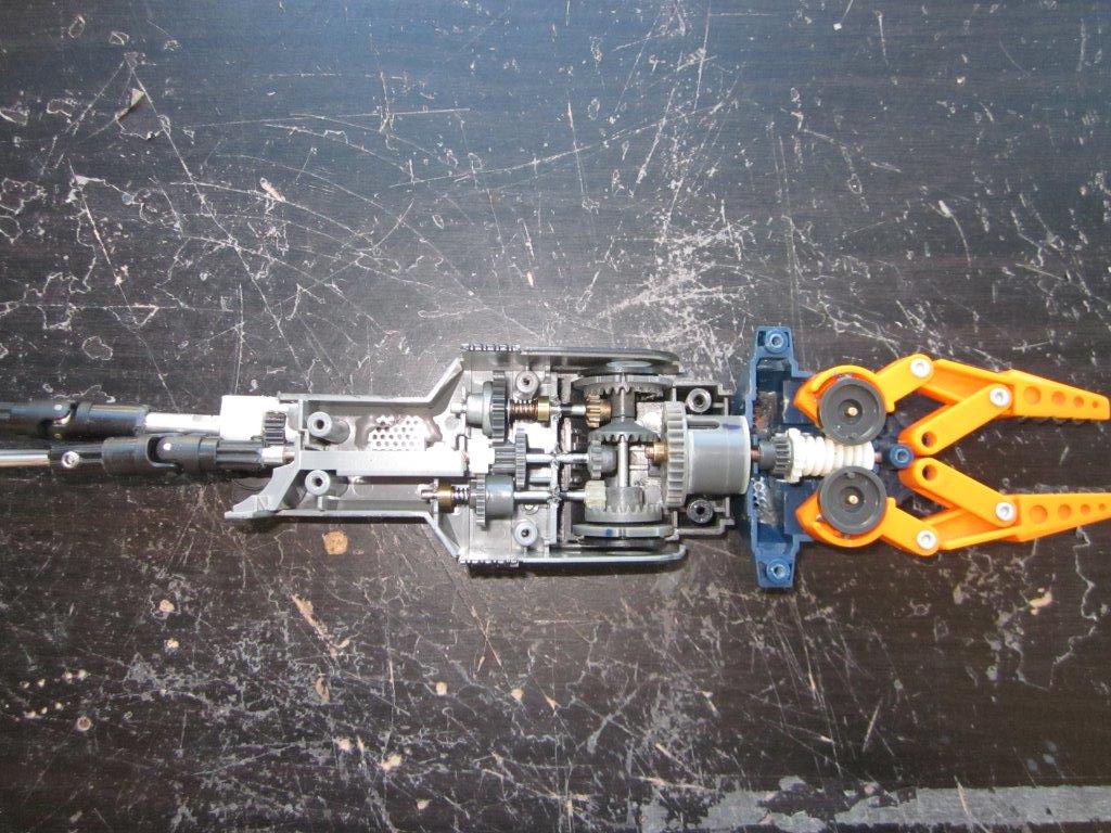

I had to do a bit of work on it so I took a few pics showing the internal layout.
