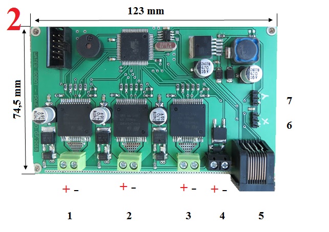

Hello. I present the printed circuit board PCB for the construction of its own design ROV

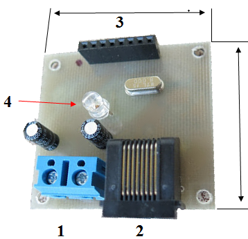

Controlled by a joystick Ps2 . Everything is TES receives ted on Ethernet cabel its length is 30m (may work on a longer cable, but have not yet tested.) 24V power supply is connected by a plate driver visible in the picture 1. Signal Communication with the joystick and power is sent through the RJ45 sheet 1 to the plate 2. Plate 2 receives the signal voltage of 24V Automatically reduces the integrated power supply for 12V, so we have the full power of our engines and lighting and we also harbor the loss of electricity.
Interior controls Bilge pump motors 500 gph DC 12V where a change in direction of movement is achieved by changing poles of power by controlling the joystick control .Interiors can also turn on the lights Power LED 6W (has been tested) by the control joystick 24V DC can be by conecting two car batteries batteries about 12V).

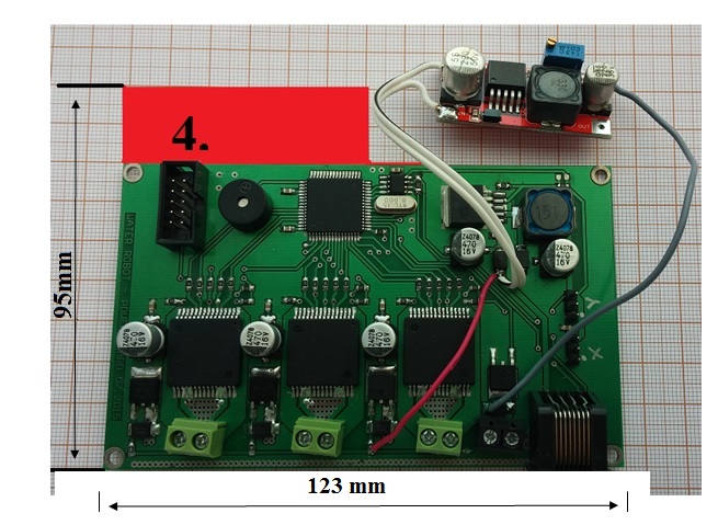

This warning previews. The disc after completing it might look like Figure 4. Finally, I want to do everything on one plate, so what you see in Figure 4, will be on one plate. The dimension is shown in Figure 4 (+ mm - mm).

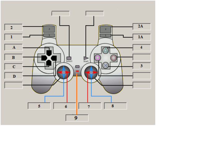

ROV CONTROL PS2
Description of buttons
1 turn to the left 100% power supply input (bilge pump)
2 turns the entrance to the left 50% of capacity (bilge pump)
(Keep the engine hold the button, release the button to stop the engine)
Turnover naked 1a right 100% power (bilge pump)
Turnover naked 2a to the right 50% of the energy (bilge pump)
3 light switch on
4 light switch
5-6 center axis of the camera, press the base X0 Y0
5 UP-DAWN Camera Control
6 left right camera control
7 CONTROL left to the right (bilge pump)
8 CONTROL forward-backward (bilge pump)
9 SELECT ON-CONTROL
CONTROL front (bilge pump)
B Left CONTROL (bilge pump)
C gain control (bilge pump)
D RIGHT CONTROL (bilge pump)
1a naked turn to the right 100% of capacity
Turnover naked 2a to the right 50% of capacity
Image Description Connectivity 1
1 Max Power 24v
2 RJ45 socket (communication, power steering)
3 Connect the Ps2
4 Led information (will be extended on 15cm)
A. Information blue color communication signaling
B. The red color lack of information about communication ps2, disconnected communication cable)
C. Green all OK info
Image Description Connectivity 2
1. max power bilge pump 12v (left engine)
2. bilge pump 12v max power (engine midlle)
3. bilge pump max power 12v (right engine)
4. Lighting 6W max power tested for lead
5. RJ45 socket (communication, power steering)
6. Servo X-axis
7. Y-axis servo
