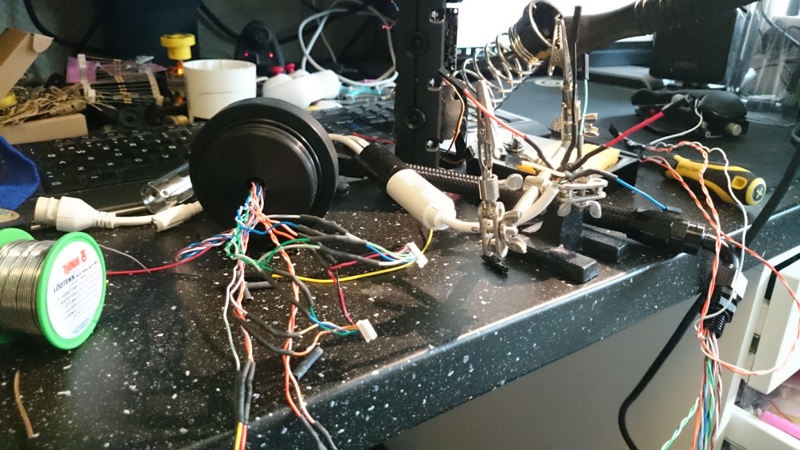

Finished wiring up everything yesterday.
Cameras still work! :D
Need to add some strain relief and cable management inside the camera house then I guess its pretty much done.
The cameras put out a bit of heat. So I am exited to see how that works out :P

Looking good... on your camera housing tube, are you just relying on the outside pressure to keep the end caps on the tube?
I'm thinking running a similar setup and it's something I always wondered about how they stayed on.
olegodo
Posts: 222
Location: Bergen, Norway
Re: I'm jumping in!
Post by olegodo »
Pretty much yes.
The fit with the o-rings is quite tight so it needs quite a bit of force to get the caps on and off. Also there is one o-ring between the end surface of the tube and endcaps. Pressure on this o-ring will increase as the outside pressure increases with depth.
Only thing that would cause enough inside pressure to pop them off would be a fire. In witch case a leak would be the least of my worries :p
