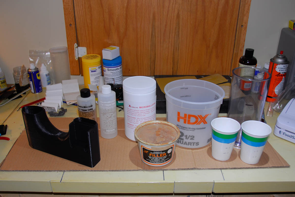

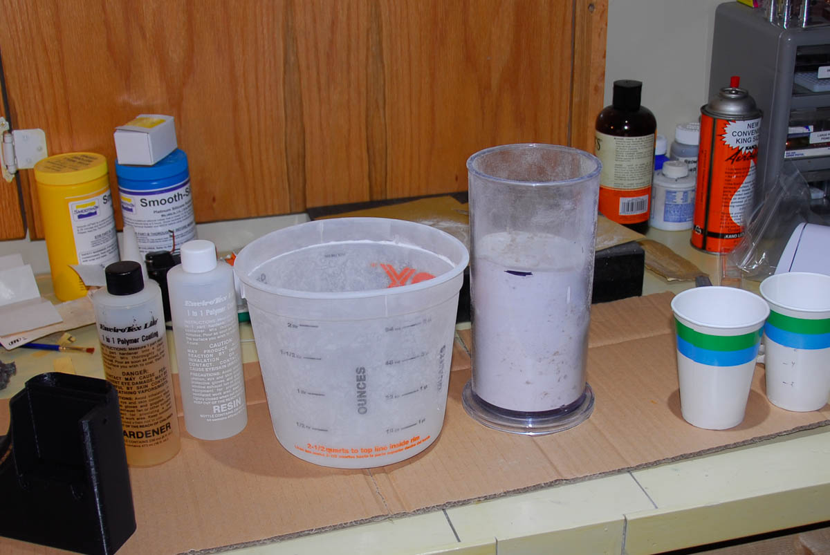

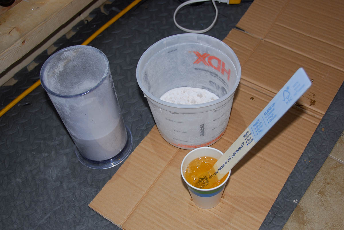

On to the fun part. :shock: I have all my stuff ready to mix up some poor mans home made syntactic foam.
The new Micro Ballons I bought seems much finer than the old stuff I had so I decided just to mix it all together before I started to make sure all the buoyancy would be the same. (even though it probably wouldn't matter but better safe than sorry later on.) This stuff is not fun to work with it floats in the air everywhere. (wear a mask if you play with this stuff.)

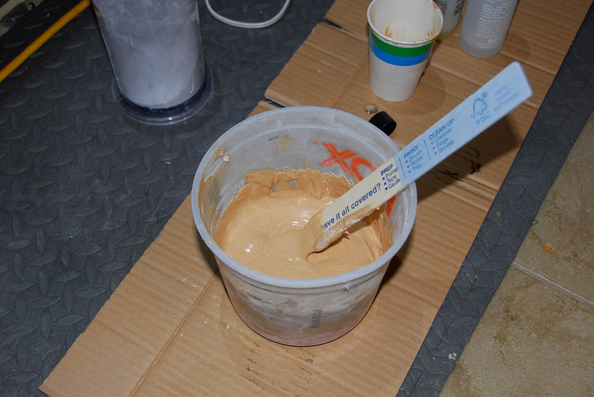

I then measured off enough Micro Balloons (in volume) to fill the entire half of the float. I know I probably shouldn't do this all at once but what the hell I just want this done at this point. :D
I think your suppose to mix half the balloons to part A of the epoxy and the other half to Part B and then mix it together but I don't know how much epoxy to use so I just dumped half the balloons in the mixing bowl and started adding mixed epoxy and more balloons until I got a consistency I liked.
I ended up using all the epoxy I had and almost all the balloons I measured out. I couldn't use all the balloons because it was getting too thick to pour.

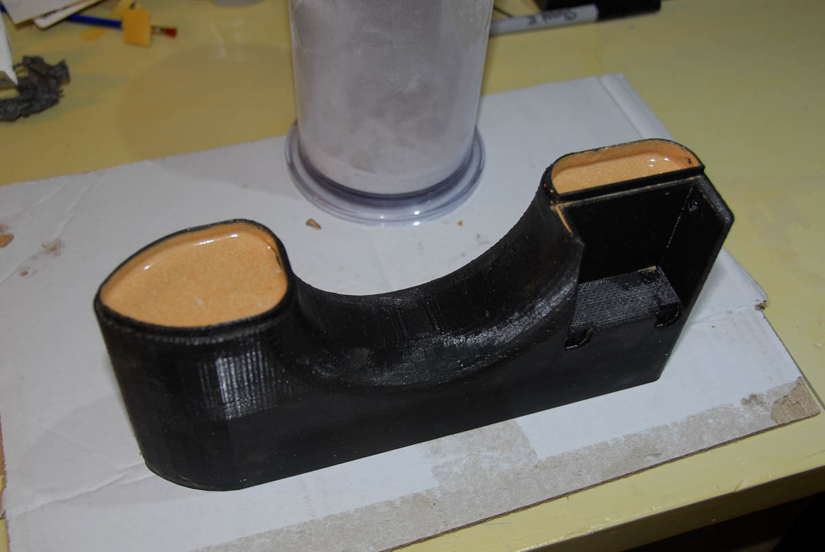

I was a little sloppy but I got most of it in there.
Back over to the case cleaner to vibrate out some air bubbles.
It was to big to fit in the pressure tank so I just left it on the bench and hope for the best. I was a little short on filling it up but that gap I need to fill in will hopefully hold the two piece together better when I fill the other half. My biggest concern right now with doing it all at once is the curing epoxy will heat up to much and melt the outer shell.
