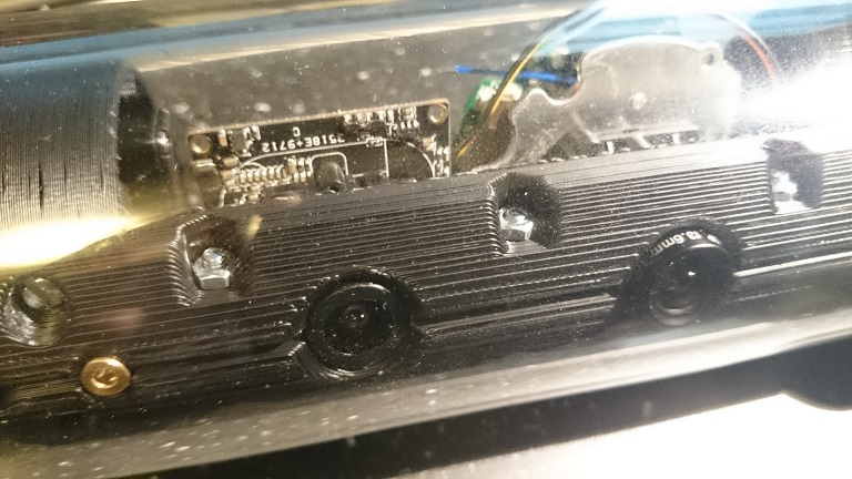

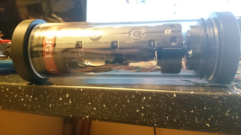

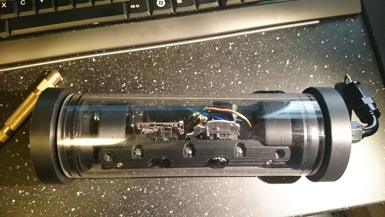

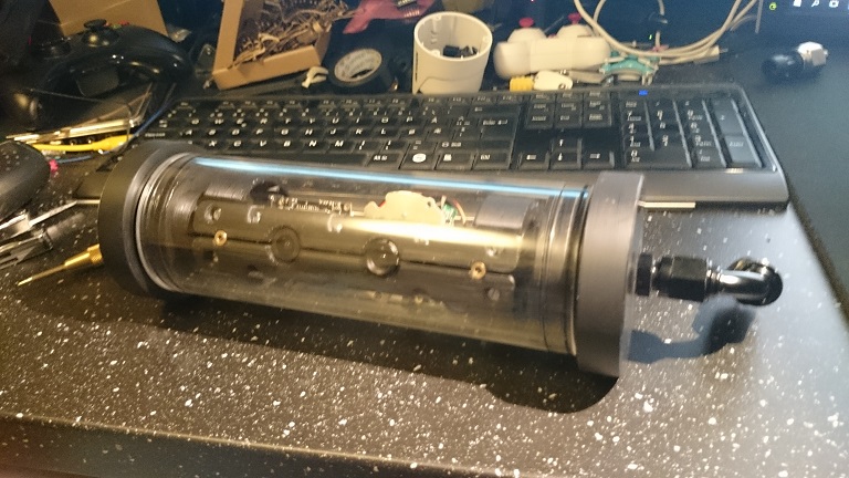

Small update
Cam tube is now almost finished.
Cabling and one more piece to print before its finished.
Inside are 3d printed parts.
One servo for rotating/looking vertically. About 160-170 degrees of movement.
Two lasers spaced 12cm apart for rough size measuring and just looking cool.
One cheap 720p ip camera witch will have a lens with a bit of zoom to better see the manipulator.
One Hikvision DS-2CD2032-I 1080P high quality camera. It does 1080p@30fps and can also do 2048×1536@20fps. But the smoother 1080p looks better. A wider angle lens will be used on this one.
I am also considering a different layout where I remove the low quality cam and add a gopro instead.. At least its possible to do.
Connection in the end is a AN6 hose, connection thingy.. Same connection in my WTC. I can fit 10 pairs of cat5 leads through (removing the outer jacket of the cat5 first)

I have now finished the cables and and hose that will connect my WTC to the camera housing.
As mentioned I have used AN6 fittings and managed to get 9 pairs of UTP cabling through it making a total of 18 leads. Should be enough.
It was an extremely difficult process, started out with 12 pairs bud had to pull out 3 to get it all the way through.
The inner diameter of the hose is bigger then the fittings, so I cut up 3 pieces of 3mm nylon 3D printer filament to tightly pack the hose. This should keep it from compressing when under pressure from the outside.
I also needed a spacer inside my camera housing and I thought "why not pimp it up a little?" So I printed the spaces with what is now my ROV's name on it.
I made the letters recessed, primed it and painted with some silver spray paint that I had laying around. After it dried, I sanded it down so that only (or mostly) the recessed letters still had paint. Not the best finish, but looks ok
The name Draug1 I got from old Norwegian folk tales that tells of a ghost, or monster of the seas called Draug or Draugen. Kind of random idea, but I liked it
Next step is to solder connectors to the cables, connect everything and see if I broke anything
